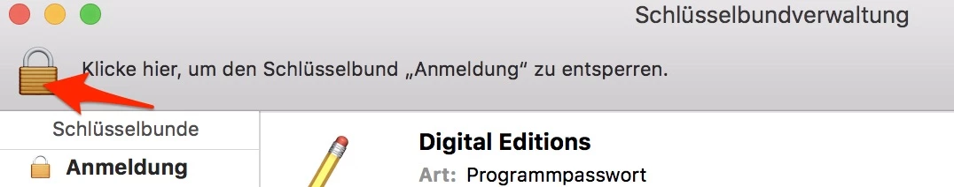

LOCKING THE LOCK ON THE KEYCHAIN ACCESS WORKED!!! I AM ECSTATIC!!!! I had previously tried ALL the solutions suggested here.  If you have not yet locked your KeyChain Access, do it. It really works. Before, I felt like I was mentally hitting the same wall over and over again. SAVED ME! THANK YOU!!!!

Hi there, I had exactly the same* problem and the solution in my case was weird but essential:
within the "keychain app", I needed to lock down "the lock" within the keychain app itself.
Once I locked it, the Adobe authorisation process went through.
