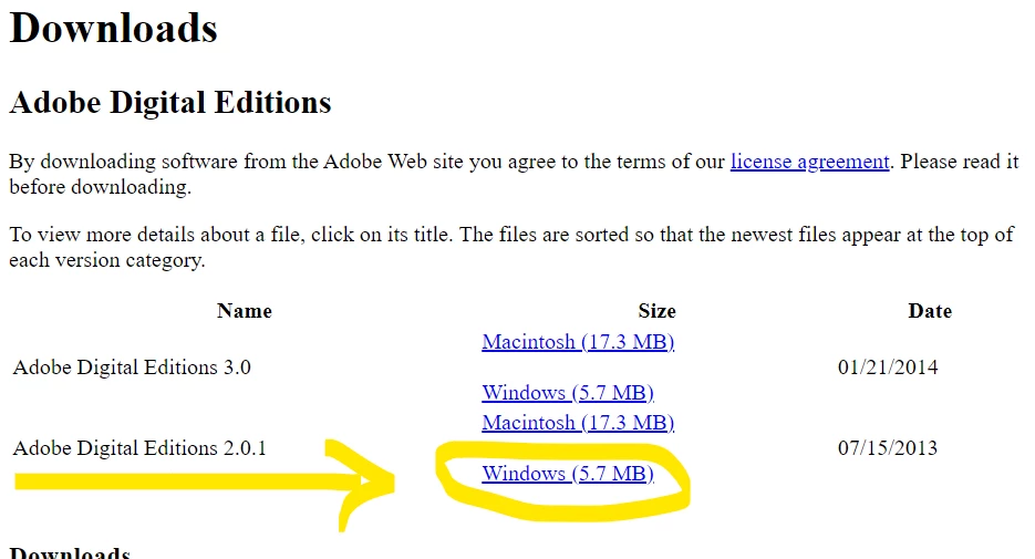

    I have an older Kobo (the Kobo Glo) and I ran into the same issue as you. I followed all the troubleshooting steps online and ran into the same problem no matter what I did. I finally fixed it; here's how:
    1) Open ADE 4.5
    2) Remove your computer's authorization
    3) Uninstall ADE 4.5
    4) Go to https://www.adobe.com/support/digitaleditions/downloads.html, scroll 2/3 of the way down the page, and click on the download link for Adobe Digital Editions 2.0.1
    5) Install ADE 2.0.1 after the file downloads
    6) Remove the "problem" book from ADE
    7) Download the book again from the public library's website
    😎 Double-click the book you downloaded in step 7
    9) When prompted, authorize your computer for ADE
    10) Click on "all items" in ADE
    11) Plug in your Kobo to the computer
    12) Drag and drop your book onto your Kobo device when it pops up in ADE
    13) Safely eject your Kobo
    14) Your book should work properly on your Kobo now.
    Feb 16, 2022 8:19 PM UTC
    Thank you very very much for your detailed description, Steven. I have a Kobo Glo and your instructions are what finally made my Kobo work again.
