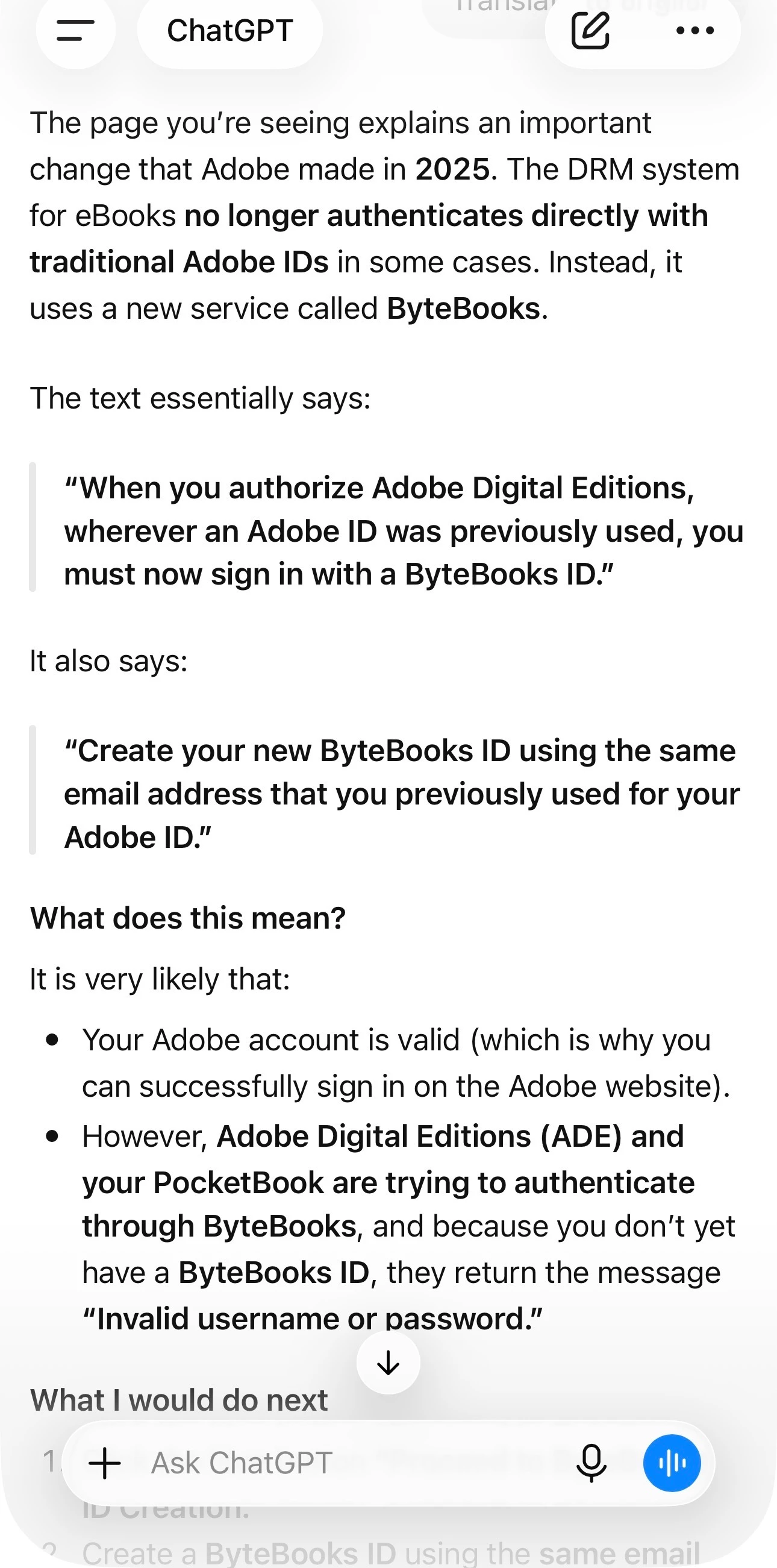

    Jul 11, 2026 9:20 AM UTC
    This worked for me
    Aug 30, 2026 11:11 AM UTC
    amazing thank you. this helped me!
