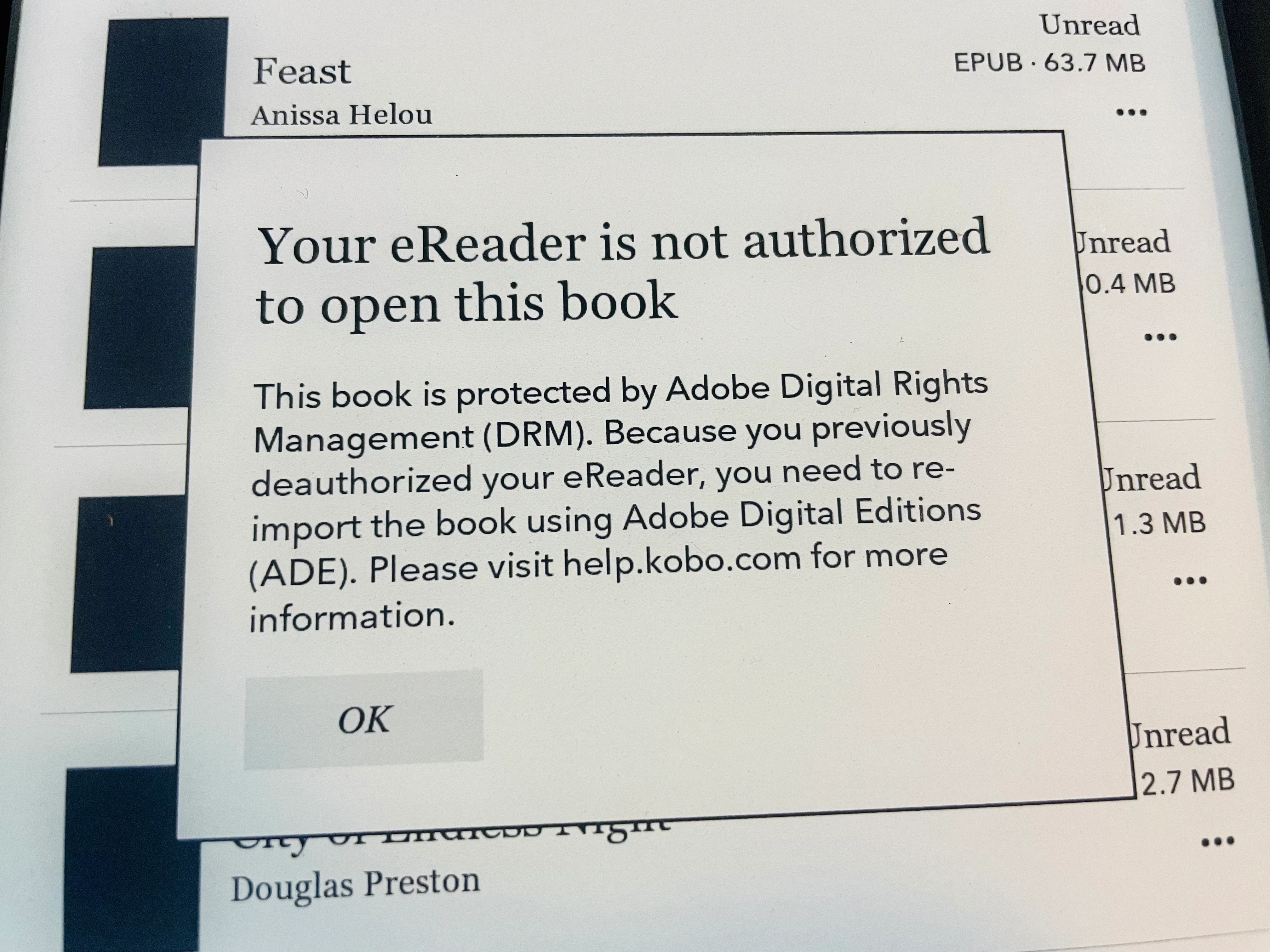

"Not Authorized" Kobo Aura H2O
Whenever I try to open a book from Overdrive on my Kobo Aura H2O, it says I'm not authorized. It was working a few weeks ago, and I can read them on my Mac with the same ID. I've tried un-authorizingg and re-authorizing on both my Mac and my Kobo. It doesn't work. t'm using version 4.5.

Adobe has completely dropped the ball on this, and given that tens, perhaps hundreds of thousands of people use ereaders to check out items from their local library with Overdrive, it's ridiculous that a company as rich as Adobe doesn't update their software so that regular folks can simply use their ADE software to sign out books and read them on their Kobos, etc. Version 3 won't work on a Mac running Big Sur, so you have to use at least v4.5.11 which is buggy. What worked for me was after removing authentication on both devices while the Kobo Aura H2O edition 1 was :
1. While Kobo was still attached, remove all previously tried books from ADE, also where the main file is kept on the Mac, remove from the Kobo.
2. Reauthorize ADE.
3. Reauthorize Kobo (still attached).
4. Restart the Kobo (this seemed to be the missing step for me)
5. Add the downloaded book (.ascm format) to ADE
6. Drag it to the Kobo listed in the ADE sidebar
7. Eject the Kobo
...and somehow the library book showed up with cover art, and not the blackened cover. I was shocked that it opened. I tried with another checked out book, this time an .epub downloaded from Overdrive on a web browser on my Mac, added it to ADE, dragged it over to the Kobo again once reattached, and it worked too. Seems like restarting the Kobo after authenticating that device is a crucial step.
Adobe should test out their software and provide clear steps to users before they lose their patience. Plus, Rakuten Kobo Inc. should put out a firmware or software update their older Kobos to use Overdrive. If you want people to use your products, give proper support please.

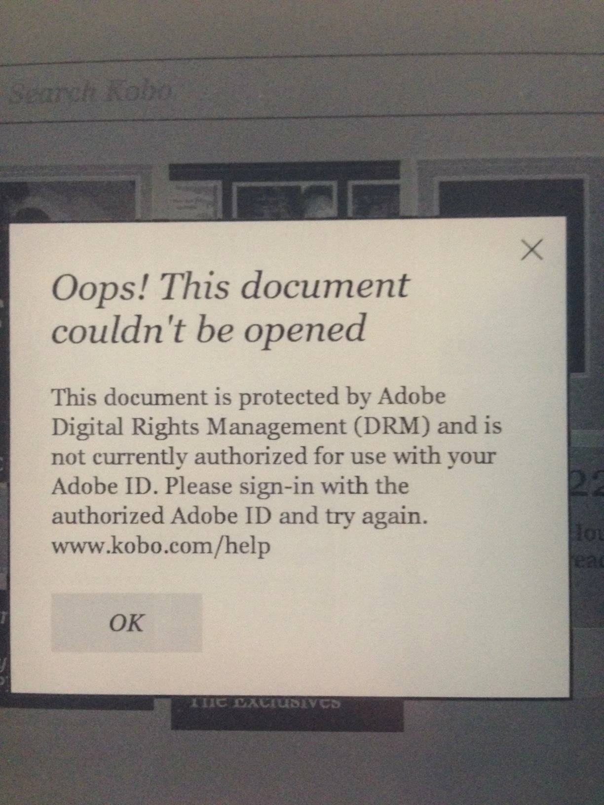

Adding to this thread because I've had a similar problem.
I have a Kobo Aura and I'm using ADE 4.5. I've followed all the steps to get Overdrive books on my Kobo. It even looks like the book downloads to the device. When I try to open it, I get the message in the image. My Adobe ID is authorized in ADE and I can see that my ID is authorized in the settings on my Kobo.
I have searched for answers and tried things suggested on various forums - restoring to factory settings, using an older version of ADE, reauthorizing the Kobo, making sure the Kobo is completely powered off before trying to download a new book. Nothing has worked so far. I've seen many posts on different forums about people having this exact same problem. It seems that something needs to be fixed on the software end and not the user end. This isn't user error.
I would really like to use my Kobo to read Overdrive books. Adobe, if you cannot provide a solution, could you please suggest who would be best for us to contact to get this resolved (is it Kobo? is it Overdrive?).
Thanks!

Oct 10, 2016 5:55 PM UTC
Hi Sharad,
I tried this (again). I still get the same message on my Kobo when I try to open the book.
Anything else I can do?
