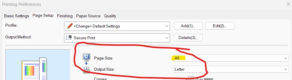

Jun 29, 2023 8:10 PM UTC
I was running into the same problem, and solved it by changing my printer settings.
I think what is happening is that something is going wrong between the size of the "book" page, and the size of the paper it's printed on. So under page set up I changed the "Page Size" setting to A5 (It had been set to "Letter." Your best setting may be different -- experiment with page sizes smaller than the paper you are printing on) and "Output Size" to "Letter" (my paper size. It had been set to "Match Page Size").
