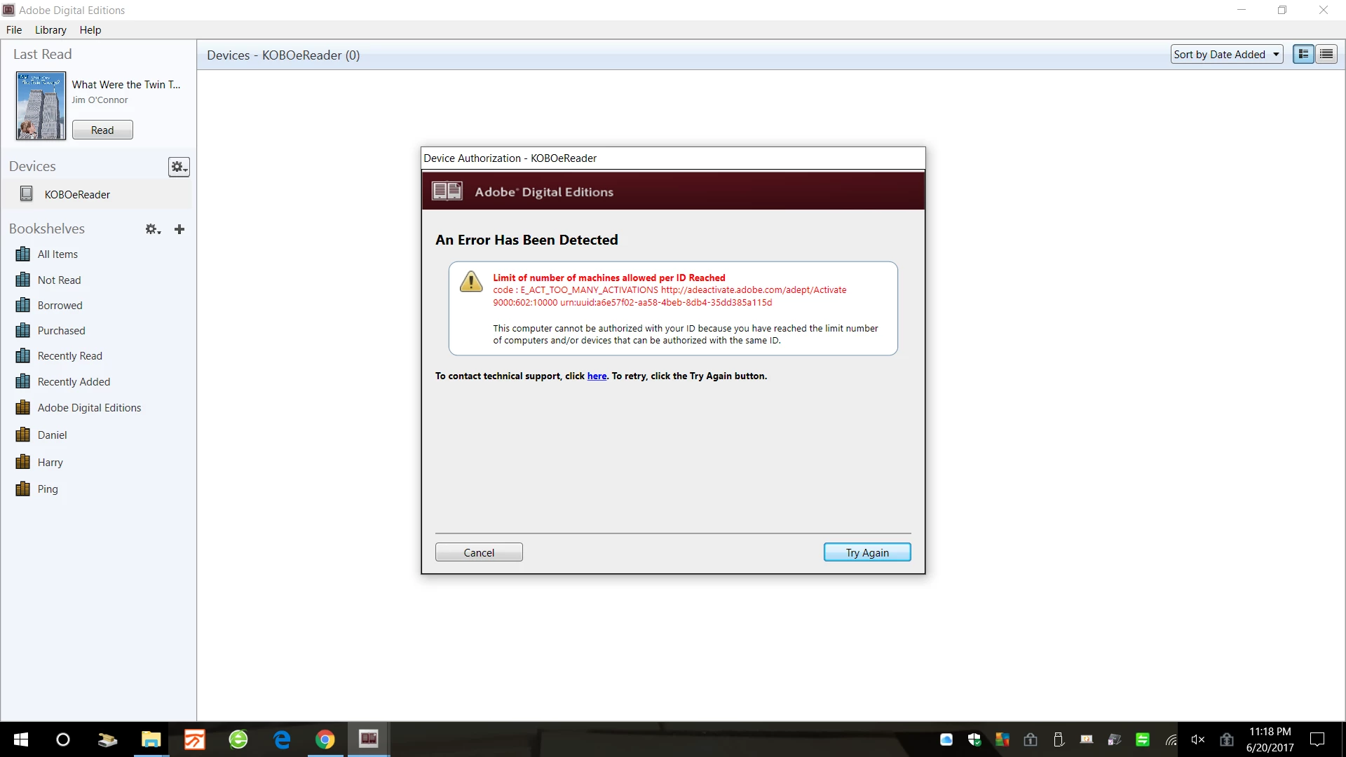

the error E_ACT_TOO_MANY_ACTIVATIONS is displayed
When I launch Adobe Digital Editions to authorize my Kobo Aura H2O, the error E_ACT_TOO_MANY_ACTIVATIONS is displayed, indicating that Limit of number of machines allowed per ID Reached. But I didn't activate Digital Editions over six devices. I contacted the Customer Care to ask them to have the activation count reset, but they did nothing and just asked me to come here to solve the problem. I can't read books on my Kobo. It's so annoying! What can I do now?

    Hi, I had the same problem. I downloaded the Adobe Digital edition app on several devices and then ereased it from all of them except my pc. Then my Kobo gave me the E_act_too_many_activation error and I eventually found out how to solve the problem. I downloded again the app on the devices and select "withdrawal the authorization" (I didn't do that when I cancelled the app) and it worked.

    Hi everyone. I had the dreaded 'too many activations' problem too after my old Kobo died. I was able to get this fixed through Adobe's Chat facility today. The support person increased the allowable number of activations for my adobe id and I can now download library books to my new Kobo via Digital Editions. What a relief!
    I had read through this forum before trying the Chat facility, so was very worried beforehand, but it all worked out fine for me.
    I went through the Adobe UK website, clicking on 'Support', then 'Contact Adobe', 'Account Issues', 'Adobe ID and signing in', 'Show me my contact options' and then 'Chat'.
    If you try this route, be patient. You will be asked stuff such as contact telephone number that seems irrelevant. You will be passed from the initial contact person to 'the relevant department', and there will be pauses while the conversation goes quiet. As an example, "I need to look up the details" took several minutes. Finally, (hopefully!), you'll be asked for your email address (meaning your adobe id), and then hopefully get the message that the number of activations has been increased. I checked that I could authorize my new Kobo while I was still online in the chat session. It worked immediately, but I did have to re-download my Overdrive library book before Adobe Digital Editions let me copy it to my Kobo.
