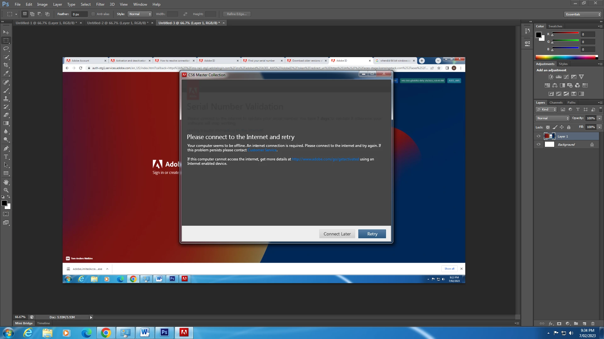

Am trying to activate CS6
Had to reformat my hard drive and reinstall
CS6 would not deactivate - kept saying  "Please connect to the internet and retry"
But my computer was connected to the internet and working
Chatted with Adobe - doe all the suggestions on all the links
Reformatted, reinstalled win 7, reinstalled Adboe CS6
Go to activate and get message "Please connect to the internet and retry"
Also tried offline activation Request Code / Response Code
Itthen bounces you to a new login page - when I enter my valid login details it says cant find an account with that email.???????   The account exists but just doesn't work for this specific login
Stuck!!!!

Adobe no longer supports TLS 1.0 and 1.1. Please check your system that you're enabled the Transport Layer Security (TLS) 1.2 protocol.
For more infos take a look here:
https://helpx.adobe.com/x-productkb/multi/eol-tls-support.html#faq
If you're using Win 7 please upgrade your OS and install the MS Easy Fix. 
Update to enable TLS 1.1 and TLS 1.2 as default secure protocols in WinHTTP in Windows (microsoft.com)
Also upgrade your browsers to enable TLS 1.2 connections.
BTW: You know, that you're using an outdated operationg system. There are no more patches and updated for secutiry leaks, So if you connect your PC to the internet there's a huge risk to get attacked and infected  You should update to a modern operating system like Windows 10/11 as soon as possible.

Hi Axel
You're 100% correct
I just worked it out for myself after finding the page which you provided the link for
It is a transport layer issue problem TLS 1.2 to be specific
Unsure what started the problem - perhaps some other update disabled it
All I needed was to run EasyFix51044 and instantly the message went away and I was able to login and activate CS6
The direct link to download EASYFIX51044 is
https://download.microsoft.com/download/0/6/5/0658B1A7-6D2E-474F-BC2C-D69E5B9E9A68/MicrosoftEasyFix51044.msi
Thanks everyone for your replies

when you reinstalled win 7, you reset your browser to an un-updated win  7 version that didn't support tls 1.2  after updating win  7 to its latest, your browser would have gained tls 1.2 support.
anyway, good to hear you got cs 6 activated.
