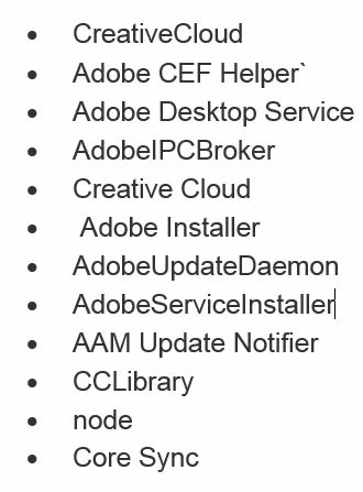

    Please close all the tasks below from the activity monitor/task manager and then check:
    Sheena
    stephanied5
    November 5, 2015
    Thank you for your reply. Unfortunately none of those are running in the Task Manager.
    When I launch Acrobat Professional DC 'PDapp.exe*32' (Adobe Application Manager) launches. When I click on 'Sign in' then 'AASIapp.exe' launches and immediately crashes.
    "Adobe Account SignIn has stopped working' is displayed. When I hit the 'close' button, AASIapp.exe closes. PDapp.exe*32 stays until I kill it.
