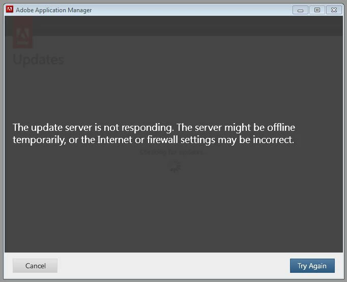

When I attempt to check for updates in either PS CS6 or Lr4, I get the error that Adobe Application Manager is unable to connect to the update server.  I've added the exception for Adobe to my firewall and also added Adobe to my trusted sites!  Any thoughts?

    Thanks Jeff, but that is not my issue. I still tried the hosts file and got the proper response and all of my Adobe products are registered. My principle product usages are both Photoshop CS6 and Photoshop Lightroom 4.
    If I manually click on either help link <check for updates...> I get the following error popup ....
    I'm using 64-bit Windows 7 and everything is functional, I just can't update!
