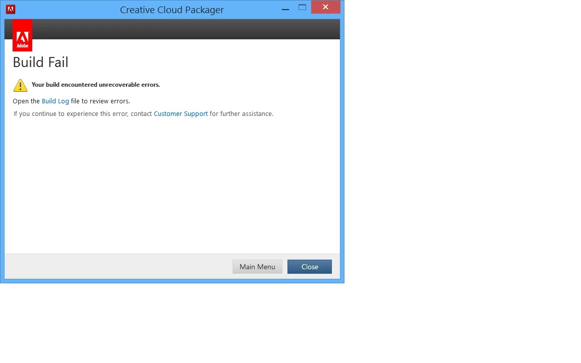

    Than you for the response - I have tried what you suggested and CCP gives the following error when trying to Build the Package:
    Here is the log file:
    1/13/2015 09:51:07[INFO] AdobePackageBuilder - Build Version - 1.7.0.43
    1/13/2015 09:51:07[INFO] AdobePackageBuilder - Logging Level verbosity Set  to 4
    1/13/2015 09:51:07 [WARN] AdobePackageBuilder - Unable to process the UpdatesInfo tag.
    1/13/2015 09:51:16 [INFO] AdobePackageBuilder - Sucessfully extracted the product at C:\Users\s294072\AppData\Local\Temp\{5AAADE50-F804-4ECF-95AD-C23C8C44D9A4}\ACCCx2_9_0_465
    1/13/2015 09:51:16 [INFO] AdobePackageBuilder - Extraction completed with return code = 0
    1/13/2015 09:51:29 [WARN] AdobePackageBuilder - No file exist at (C:\Users\s294072\Downloads\Adobe Presenter CC10.0 x86\Build\ASU\Tools\CCC\Uninstall\deploy\remove.xml)
    1/13/2015 09:51:30 [ERROR] AdobePackageBuilder - Failed to get folder size (C:\Users\s294072\Downloads\Adobe Presenter 10\Presenterwin32\payloads\Redist_1_SSCERuntimex86)
    So if you have any more assistance you can offer that would be much appreciated
    Cheers - Paul
