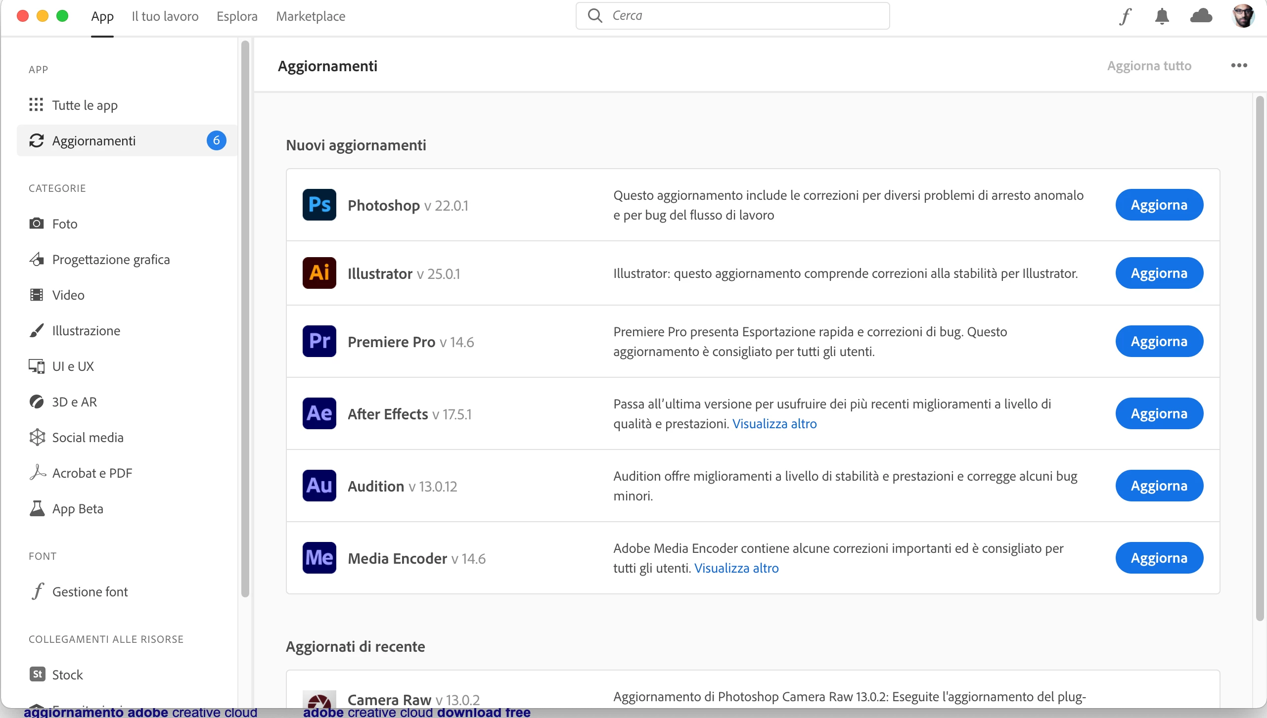

Hi, i've update my imac with Big Sur, but now but now creative clouds doesn't update the apps.
Has this happened to anyone else?
Thanks

big sur is not compatible with some cc apps (eg, animate and acrobat) and there are compatible/installable programs that have problems with big sur.
that's said, what problem are you seeing when you try to update?
