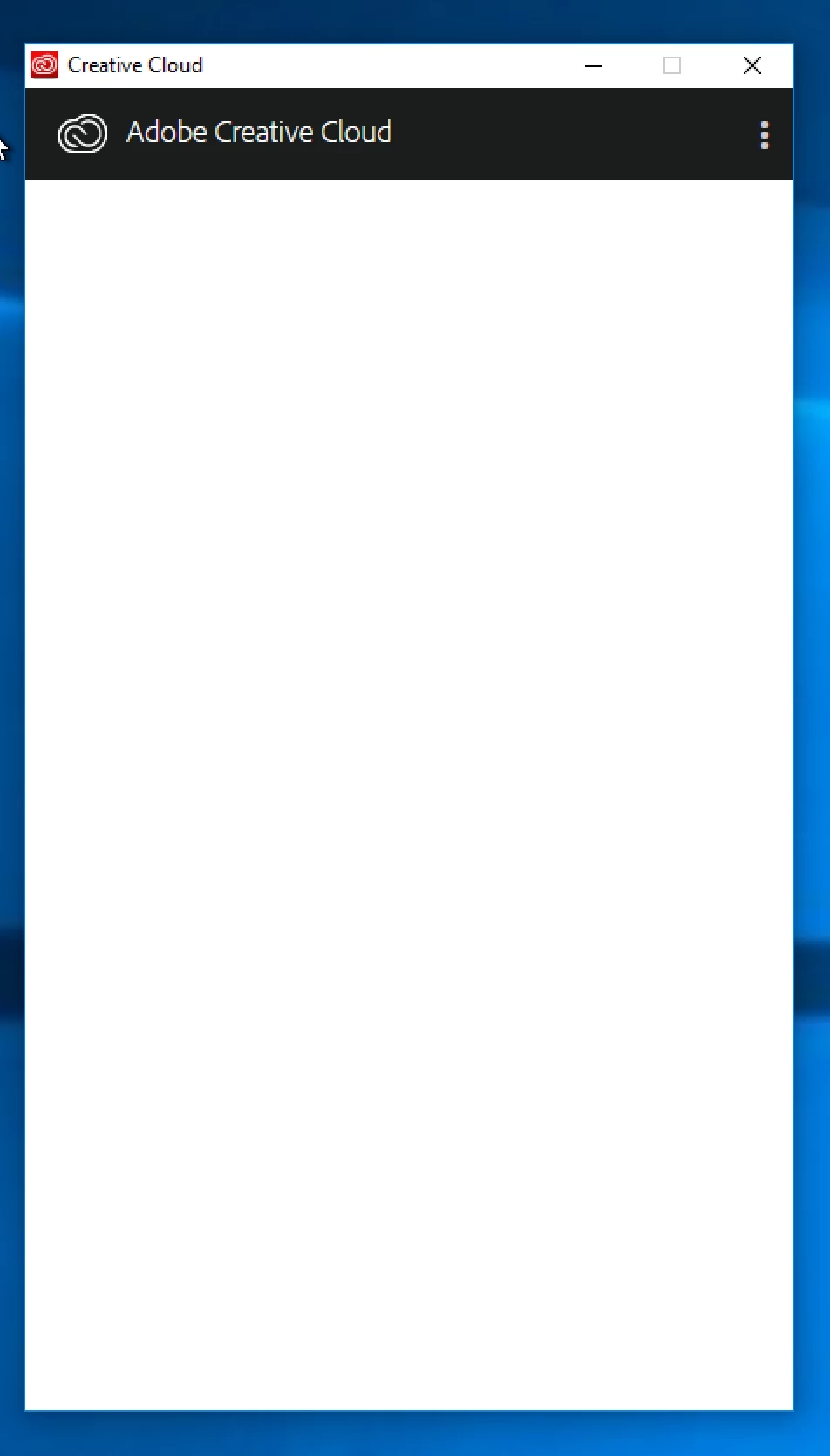

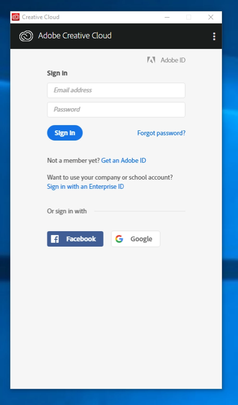

I've tried every solution on here (network settings, re-installing CC desktop app, deleting particular temporary files, running as administrator, etc.).  I also did a screen share for a couple hours with Adobe Support, which did not resolve the problem. My problem is that I can log in, but I get a blank screen and/or spinning circle.  Then I get logged out after about 30 seconds and I get the sign-in screen again, or an error message that Creative Cloud is missing and needs to be reinstalled.
This is on a fresh installation of Windows 10 running in Virtualbox on Red Hat Enterprise Linux 7.  Every other application requiring an internet connection (including, e.g., Office 365) works properly, but I'm locked out of my Creative Cloud account!  I'm losing serious money from not being able to work, please help!
