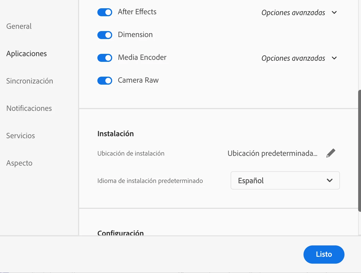

Can I change the location of the installation and more to a external Disc?
Greetigns for all!!
I have a little space in my hard disc. So I would like to know if is posible to change the location of the installation to a External Disc from the window that I add in the picture 1.
Or what is the best way to save space on my hard drive with Adobe?
Thank you so much for your help

and no. you can't install your apps on an external device.  you can save your production files anywhere, even off-compt.

You have the wrong computer. This is not adequate for running high end design apps. (You can of course keep your media on an external disk).
Oct 13, 2022 9:15 PM UTC
Thanks friend!! is this possible? can I keep the adobe apps in an external disc?

No, you need to install the programs on an internal drive. All your data can be kept on an external drive.

No, Adobe apps cannot be installed on removable media. There's no way around it: You have to get a bigger internal disk or install a second one if you can.

Thank you so much for your help. My disc is 250 Gb, but I work with audio and video and I only have 50 Gb free in this moment, but If is posible to add other disc more, this can be a solution for my problem.
Oct 12, 2022 11:05 AM UTC
Your disk size is still relatively small. Besides having a large primary hard drive, you can have a second drive (even external) for your media. Keeping your programs and projects on different drives is worth doing.
If you get a second internal drive and try install programs on it, you will still need space (can be 4GB+) on the primary drive for the application to install and run.
