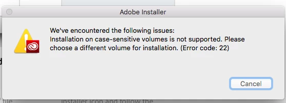

Can't install Creative Cloud on "Case Sensitive Hard Drive" ???
  • April 3, 2018
  • 6 replies
  • 3783 views
Correct answer thatsmauri
Hi KieranBrennanDublin,
the Adobe Apps don't like case-sensitive file systems, such as HSFX (HFS+) or UFS
Please take a look at this help page: Adobe error "Case-sensitive drives not supported" or similar install error | Mac OS
The only solution is to install the Creative Cloud and its Apps on a non-case-sensitive drive.
Kind Regards,
Maurice

April 3, 2018
Thanks Maurice;
I've re-formatted the HD and all is well.
Thanks again
K
