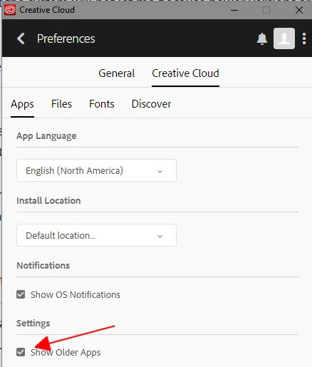

did you use the cleaner?
do you have the option to show older apps in your cc app preferences ticked?

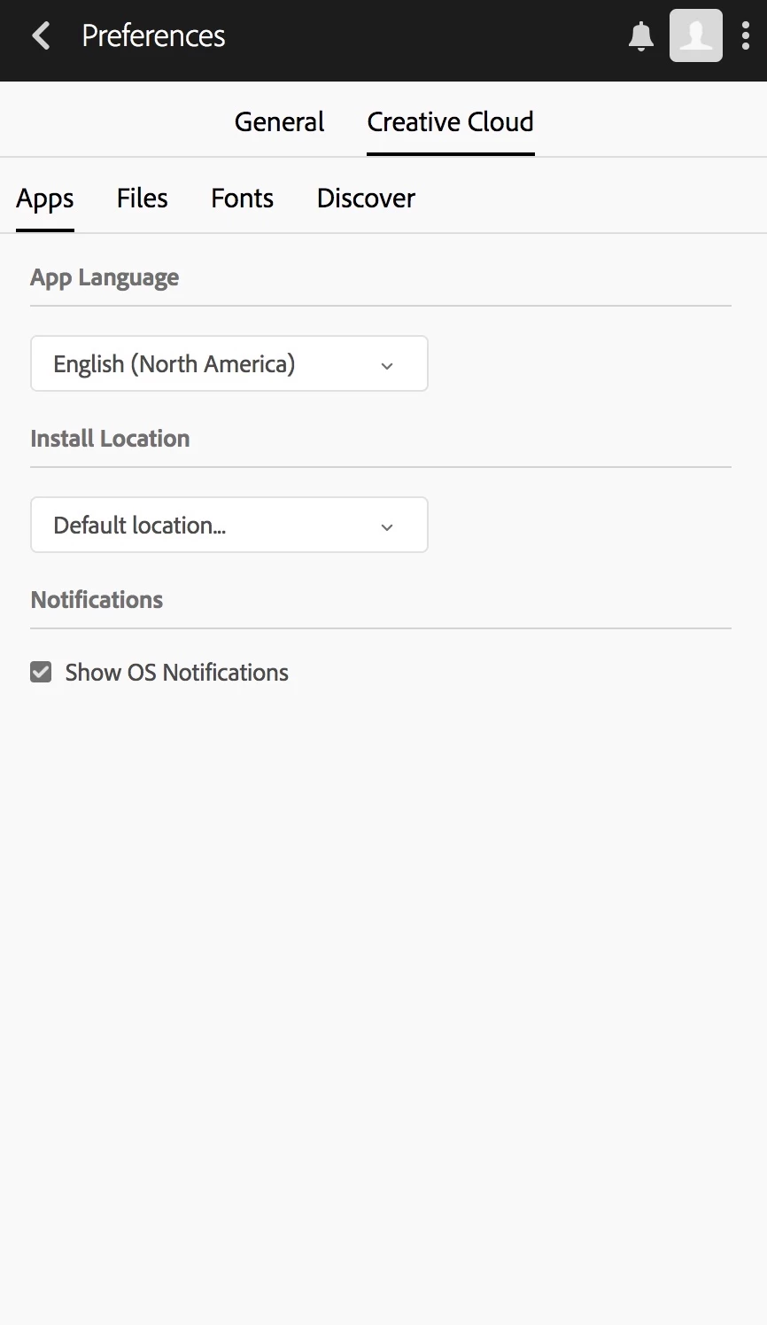

As stated in my original post, the Cleaner has been run.
Also, there is no option to select as shown in your picture.  BELOW is what shows after I've cleared all the 2018 apps from CC, ran the CC Uninstall app, ran the Cleaner app, and reinstalled the CC Installer (apologies for the large size... with no access to a photo editing suite, I was unable to resize it.
