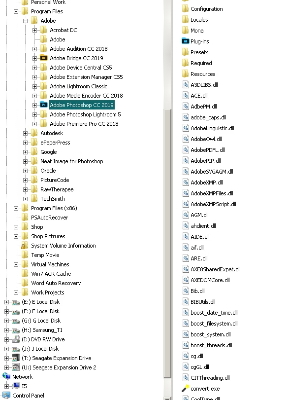

PS is now up to 20.0.6. That is an UPDATE to 20.0.1. If you remove what looks like 20.0.1 in the Windows Add-Remove programs you might just remove PS 20.0.6, the most current version.
Take a look at the Adobe program folder under C:\Program Files\Adobe. Do you see a folder for PS 2018 or 2017 (or whatever other than Photoshop CC 2019)? If not I would stop worrying about what you may see in the Windows Add-Remove or Programs and Features section of the Windows settings or Control Panel.
If you do find any PS folders other than CC 2019 then look in them to see if there is an uninstall program (.EXE) and exactly what is in those folders.
I have had PS installed on my present computer since PS 5 and now PS CC 2019. Here is a screen shot of the program folder that I have all my Adobe product installed to.
