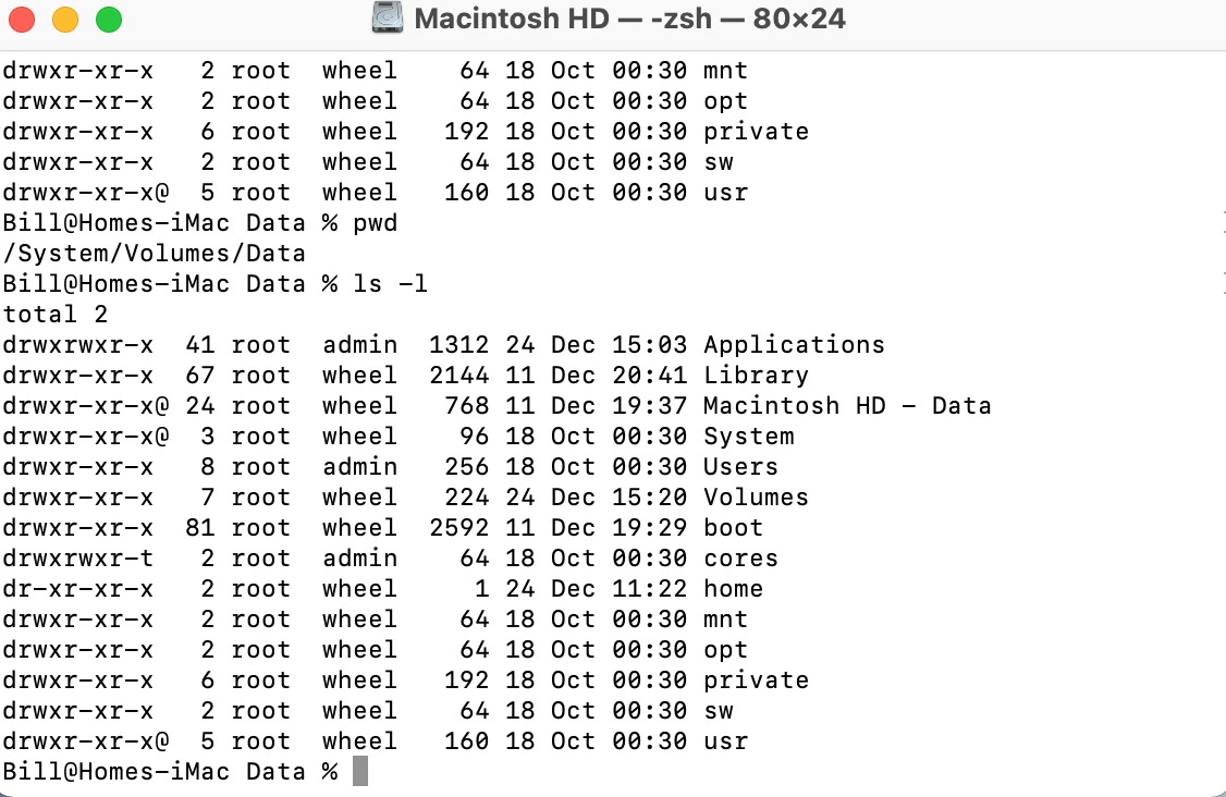

Well I'm assuming it's the target folder Library/Application Support/Adobe/Startup Scripts CC/Adobe Photoshop.
 because as I understand it it's trying to move it from /System/Volumes/Data/.adobeTemp/51E31BB9-481D-4042-B52D-ED6A3992356A/2/Common Files/Adobe/Startup Scripts CC/Adobe Photoshop where it has transferred it to during the installation download to the actual app folder.
If you have any idea  I'd be grateful for suggestions.
Thanks
OK looking a bit further into this I find there is no such folder "/System/Volumes/Data/.adobeTemp/51E31BB9-481D-4042-B52D-ED6A3992356A/2/Common Files/Adobe/Startup Scripts CC/Adobe Photoshop" see screenshot of terminal
So I guess it can't find the file to move in the first place. Any ideas?
Surely someone else must have experienced this? I can't believe I'm the first person to try to update using Monterey and new photoshop.
