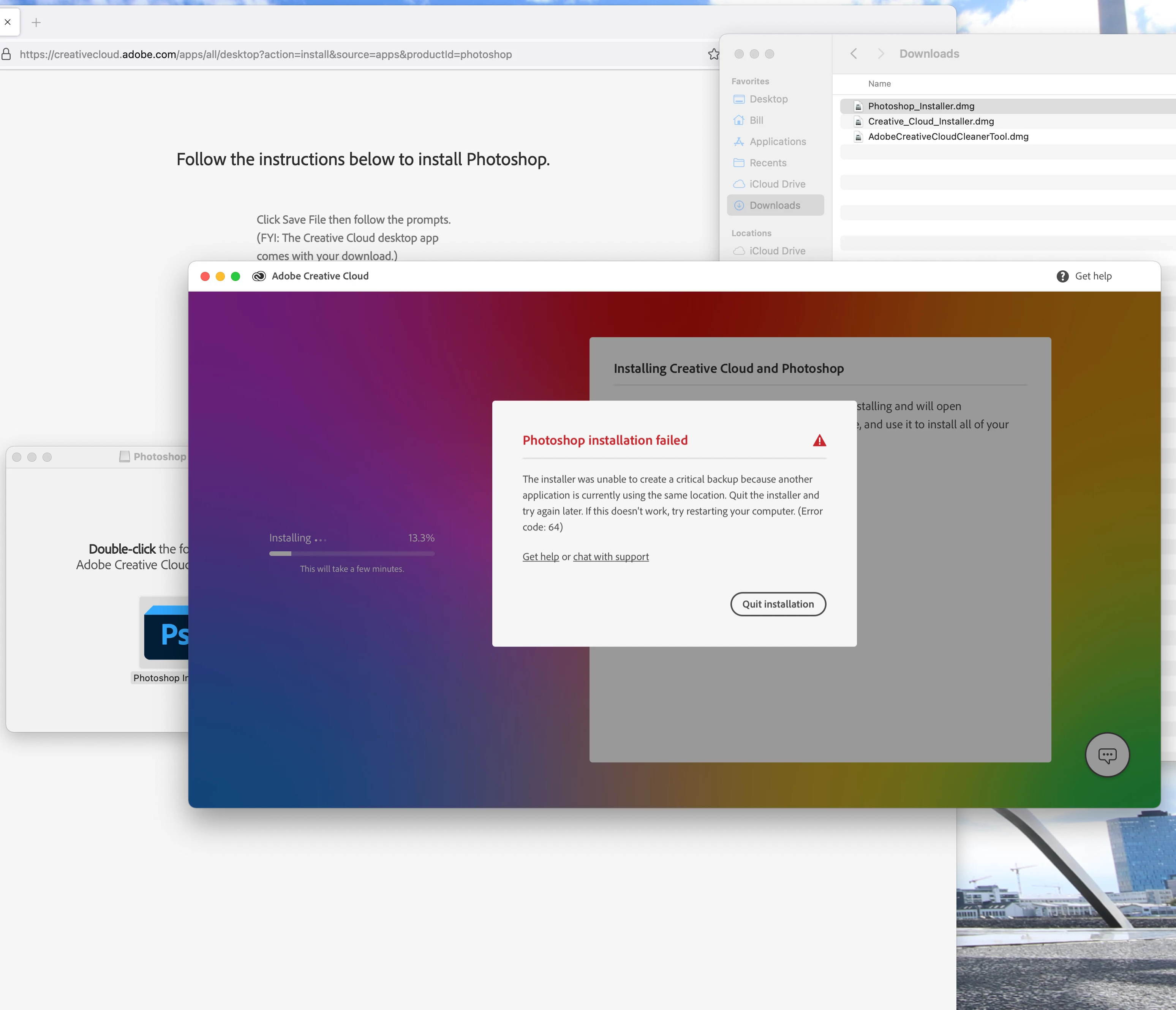

I cannot update any CC apps. Every time I try it says Cannot create critical backup because another application is using that location. There are NO other applications running.I have switched off every possible backup on any other apps. I have physically removed the backup drives. I have deleted every instance of any Adobe application I can find.
Yet still every time I get the error :64 which is nowhere referenced on the adobe site. See attached screenshot.
This happens if i use Creative Cloud desktop app, or Photoshop installation app, all newly downloaded direct from my adobe account
Correct answer william22213005vimr
using a browser that allows popups and cookies, contact adobe support during pst business hours by clicking here, https://helpx.adobe.com/contact.html?rghtup=autoOpen
in the chat field (lower right), type AGENT
be patient, it can take quite a while to reach a human
Finally cracked it.  For some reason a number of files were unable to be overwritten. The removal tool did NOT remove these files. I could not remove these files even using my admin privileges. Ultimately logged in as root user and used terminal sudo commands to remove the file named in the error file. After that it was a painful process of repeating the installation, and each time it got a bit further, with error 146 giving a new "unmoveable" file each tiem, and I was able  eventually as Root/Sudo to remove each file described .
I don't know why this was necesary as the original installation was done as my normal user..... Not sure if the multiple attempted installs had any impact . But the lesson is use root sudo to remove the "problem" files.....

Once again, I performed all the steps as noted in that link, the cleanup tool reported all complete, I quit restarted computer, all CC apps ha dgone, as I expected, so I then redownloaded tand ran he Creative Cloud app and exactly the same thing happened it got to about 13.8 % and said installation failed because cant create critical backupSee attachment. \
NOTHING else is running. I have DISCONNECTED all backup drives. Fortunately I made a backup previously so I'll revert to theat and at least have something.
January 13, 2022
This is not normal. I would do some checking to see if there are problems or corruption on that drive.

The very first step does not work. When I try to run the uninstaller it says "Creative Cloud Uninstaller.app needs to be updated." That is exactly what I am trying to do and it always fails. with error:64 even after I have performed all the steps in this message.
