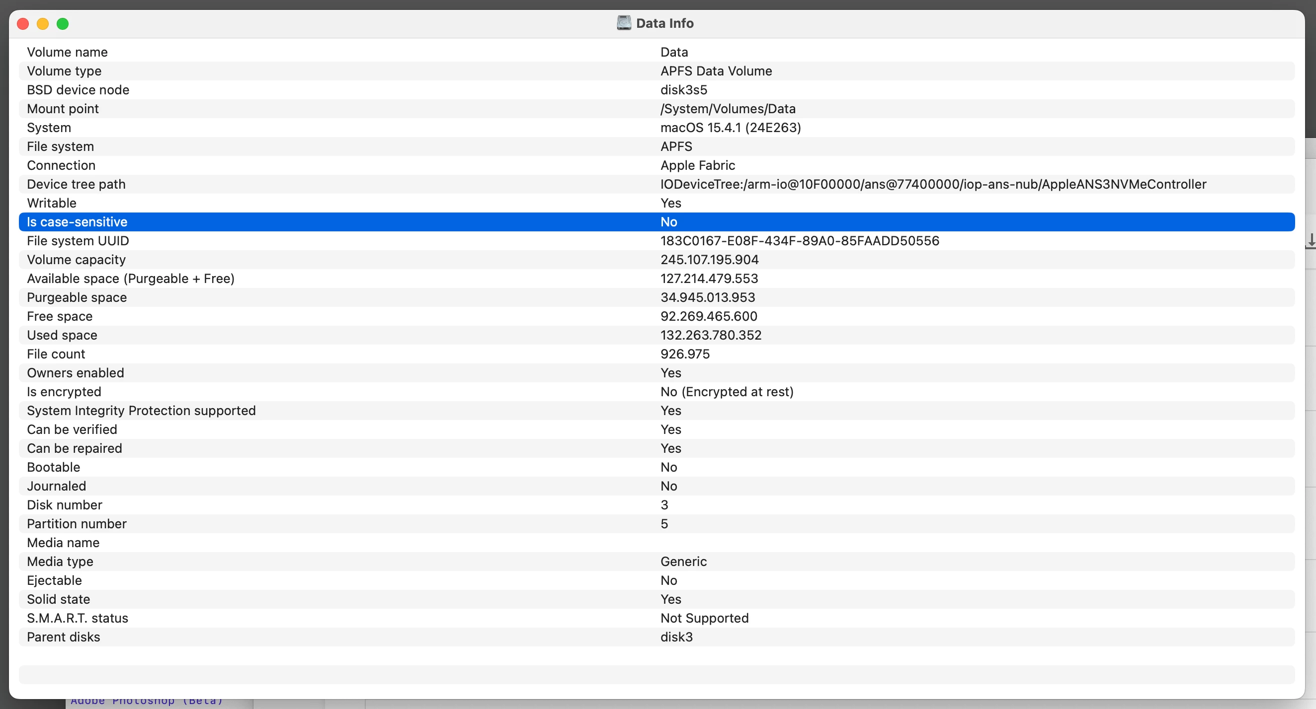

Hi, I've a strange problem with PS update... Both update to 26.6.1 and install of PS Beta 26.8 fails with this error message:
Exit Code: 181
-------------------------------------- Summary --------------------------------------
 - 1 fatal error(s), 1 error(s), 0 warnings(s)
FATAL: Error occurred in install product workflow with error code 181 error message
ERROR: Can't install to a case sensitive drive
I have installed all Adobe ecosystem in /Applications folder, that in MacOS is a link to /System/Volumes/Data, and this volume IS NOT a case sensitive drive! (see attachment)
I've had no problems updating LR, LrC, Camera raw and so on, that are installed in the same folder.
I've also tried to completely uninstall PS Beta and now I can't reinstall it.
Any ideas? Thanks
Something about that drive/volume is being mis-identified by the installer... I'm on Windows, so I don't know why
il_waltiAuthor
May 9, 2025 6:55 PM UTC
Adobe Support is stuck repeating that the drive IS case sensitive, but this is wrong... I'm (was) an Unix system engineer for 40+ years, so I think I do know what I see...
A simple test:
$ cd /Applications
$ touch Test
$ rm test
$ cd /Volumes/Extra/Applications (A CASE SENSITIVE DISK!!)
$ touch Test
$ rm test
rm: test: No such file or directory
That's so simple...

what's your install path?
kglad
May 9, 2025 6:29 PM UTC
are you using a case sensitive hard drive?
il_waltiAuthor
May 9, 2025 6:49 PM UTC
No, of course not.
