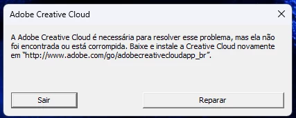

I am attaching two prints, one that shows the error while the app is loading and another that shows the error window when the launch fails.
The first image says "Creative Cloud is taking more than normal to load. Get Help."
And the second one says: "Adobe Creative Cloud is needed to solve this issue, but it is not found or it is corrupted. Download and install Creative Cloud again in [link]".

skip to a clean install.
reset the cc desktop app by making sure it's in the foreground, then press:
Win: Ctrl + Alt + R
Mac: Cmd + Opt + R
if that fails, repair per https://helpx.adobe.com/download-install/kb/creative-cloud-install-stuck.html
if that fails and you have windows, open your control panel > add/remove programs > cc desktop app > repair
if that fails, uninstall using the correct uninstaller from https://helpx.adobe.com/creative-cloud/help/uninstall-creative-cloud-desktop-app.html#sa_src=web-messaging and then reinstall using*
if that fails, do a clean cc install carefully following each applicable step:
uninstall every cc app including preferences per https://helpx.adobe.com/creative-cloud/help/uninstall-remove-app.html
then uninstall the cc desktop app, again using the correct uninstaller per https://helpx.adobe.com/creative-cloud/help/uninstall-creative-cloud-desktop-app.html#sa_src=web-messaging
clean your computer of cc files per http://www.adobe.com/support/contact/cscleanertool.html
check for, and if available, update your os
if windows is your os, repair all ms visual c++ versions that can be repaired (use google if you don't know how to do this)
if windows is your os update your ms visual c++, if it can be updated (use google if you don't know how to do this)
restart your computer (don't skip this)
reinstall the cc desktop app using the "alternative download links" at the bottom of the page at https://helpx.adobe.com/download-install/kb/creative-cloud-desktop-app-download.html
use the desktop app to install your cc programs/trials>
if that fails, you probably have a corrupt user account. google your os and how to create a new one.

Hey kglad, thank you very much for your help. It finally worked. It was the Visual C++ that was not updated in my machine. I installed it's latest version and the CC app now works fine.
They could have a more clear error message for this, informing the user that the app need a new C++ version... It would save a lot of headache.
