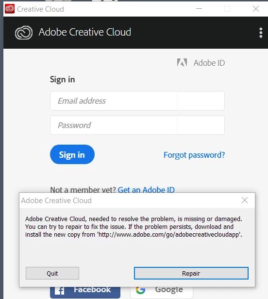

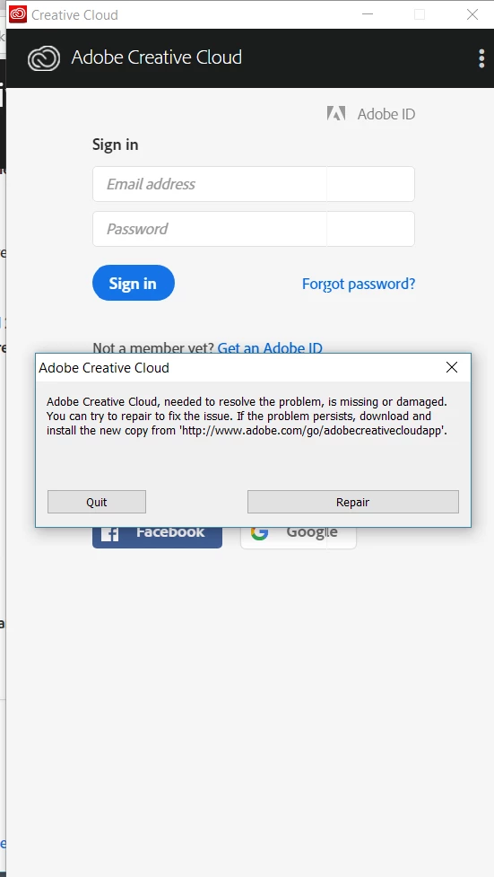

CC desktop app wouldn't start.  I removed Lightroom, Photoshop, then CC itself.   I ran the AdobeCreativeCloudCleanerTool.exe and redownloaded and reinstalled CC desktop app.   Installation seemed to go OK.  At the end the Creative Cloud app window comes up and the 'loading...' circle spins for 60 secs, then t flash in the black band, then the circle spins for another 60 secs, then another flash, etc  - 3X, then a dialog comes up:  Title Bar: 'Adobe Creative Cloud'   Body: "Adobe Creative Cloud, needed to resolve the problem, is missing, or damaged.  you can try to repair to fix the issue.  If the problem persists, download and install the new copy from 'http://www.adobe.com/go/adobecreatecloudapp'. "   Two buttons are shown [Quit]  and [Repair].    Repair fails.    When I click [Quit]  the dialog disappears and there is text remaining in the window very briefly, then the window exits.   After the exit task manager shows:

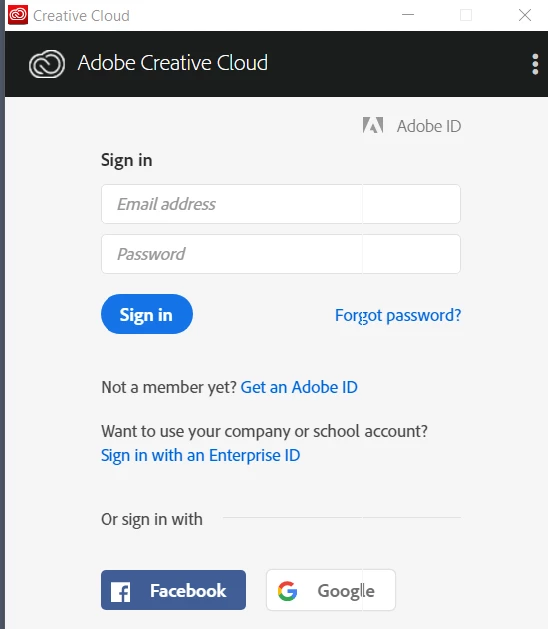

I re-tried all the options listed at the two URLs. This time I renamed the OOBE folders.   I got farther, but still have problems:
When I close the dialog box, the Creative Clout app exits.
I was able to restart Creative Cloud app using the Icon left by the install.
This time the sign in dialog appears.   I entered by credentials, and the window contents turn white for a minute, then the  timing circle spins in the middle, and I am returned to the Sign-In dialog.
This display remains for a while, then the faimilar diaglog appears:
After clicking [Repair]  the Adobe Installer  downloads the Creative Cloud desktop app again.
It installed, came up, accepted my credentials, when white,  and asked for my credentials again.
