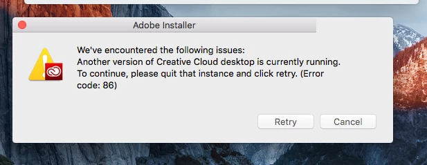

J Dr.Author
September 5, 2016
Here is a screenshot of the message I receive when I try to manually install the Creative Cloud app.  Thank you for your reply.
alainb91171264
September 6, 2016
This is exactly the same problem I have.
The icon of Creative Cloud desktop on the top of my screen is gone.
If I try to start the program by clicking the icon in the dock I get the message that the program is no longer in use.
If I try to uninstall I get the message that I can't uninstall because there are Creative cloud applications on my system that need the Creative cloud desktop app to run.
The only thing I can do is click close.
If I restart my computer the icon on the top of my screen is back and I get the message that there's an update for the Creative cloud desktop app.
And we're back in the same loop.
