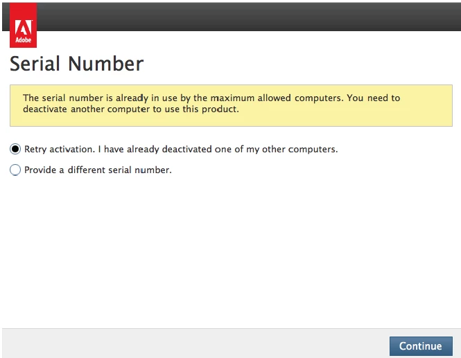

if failure to deactivate (ie, you exceeded your allowed activations) were the problem, you would see this error message
and adobe support could reset your activation count.  that's the only help you'll get from adobe for trying to install cs6 (as you confirmed).  if that's the error message you are now seeing, contact support as indicated above.  otherwise, read further:
swapping your hd from one mac to another is guaranteed to cause a problem with adobe software because the machine id's won't match and you'll see a licensing error message (as you reported).
at that point, you need to either remove or wipe clean (eg, reformat) that ssd and properly install cs6, or try a directed cleaning of all adobe software from that ssd.  a directed cleaning is apt to fail, but it is less aggressive than a removal and than a reformatting and, if it does fail, you can proceed to removal or reformatting.
