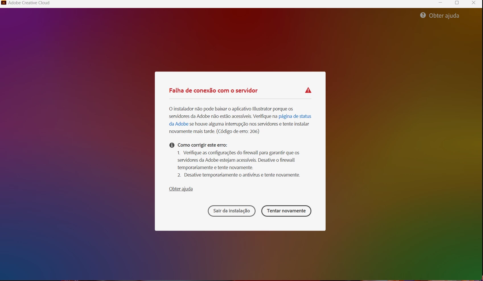

erro de instalação
adquiri recentemente o pacote adobe porém quando vou instalar os aplicativos que precisso (Photoshop, Ilustration, Premiere) conta erro de firewall assim como na imagem em anexo.
Ja desativei o antivirus como suger

    adobe connection errors are common and are not related to whether you're connected to the internet.  they're related to connecting to adobe's secure servers.
    if you have a non-current os, your default browser must support tls 1.2, https://helpx.adobe.com/x-productkb/multi/eol-tls-support.html
    to test your default browser's tls you can use , https://clienttest.ssllabs.com:8443/ssltest/viewMyClient.html
    otherwise, confirm that you can connect to the secure adobe servers by reading, http://helpx.adobe.com/x-productkb/policy-pricing/activation-network-issues.html
    do you see both logos after clicking "link"?
    if you can and still see a connection error try these steps, https://helpx.adobe.com/download-install/kb/common-network-connectivity-issues.html
    if those all fail, white list the adobe network endpoints, https://helpx.adobe.com/enterprise/kb/network-endpoints.html
    or, if you’re trying to activate a perpetual license, you can try offline activation by disconnecting your computer from the internet, starting activation and using https://aoes-stage.licensingstack.com/aoes/aoes/v1/imsauthstatus
