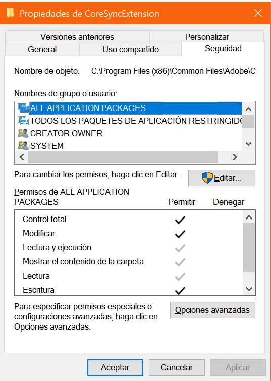

 What I ended up doing was accessing the specified folder, changing the specified file to .bkp instead of the .dll file type it had, and then going to the root folder and editing the Security Settings in the Properties window of the folder. There I changed the permits from ALL APPLICATION PACKAGES group and enabled the Modify and Total Control options. This solved my issue. I hope it is helpful for you as well. I'll leave you here a screenshot of this last window, though sorry it's in Spanish.

Me solucionaste la existencia! GRACIASSSS
