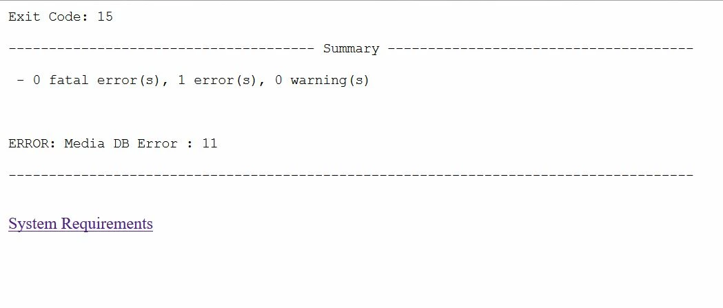

Dear Sir or Madam,
I recently tried to install my Creative Suite 6 on my new Windows 10 Computer.
Unfortunately, whenever I start the installation, it stops at about 2% with the Error Message Exit Code 15 as shown in the picture.

    Correct answer Govardhan.V
    Have you installed any other Adobe apps using serial number ?
    If you haven't installed any other Adobe apps , you may try renaming below mentioned folder and then try to install.,
    C: >Program Files(x86) > Common Files > Adobe> Caps.
    rename Caps folder to Caps-old.
    Then try to install and check .
    Still same ?? let us know.
    Govardhan.V

    Panda_Baerchen
    October 6, 2016
    Thank you very much for your help!
    I just successfully installed my Creative Suite and ran the first program.
    You really made my day.
