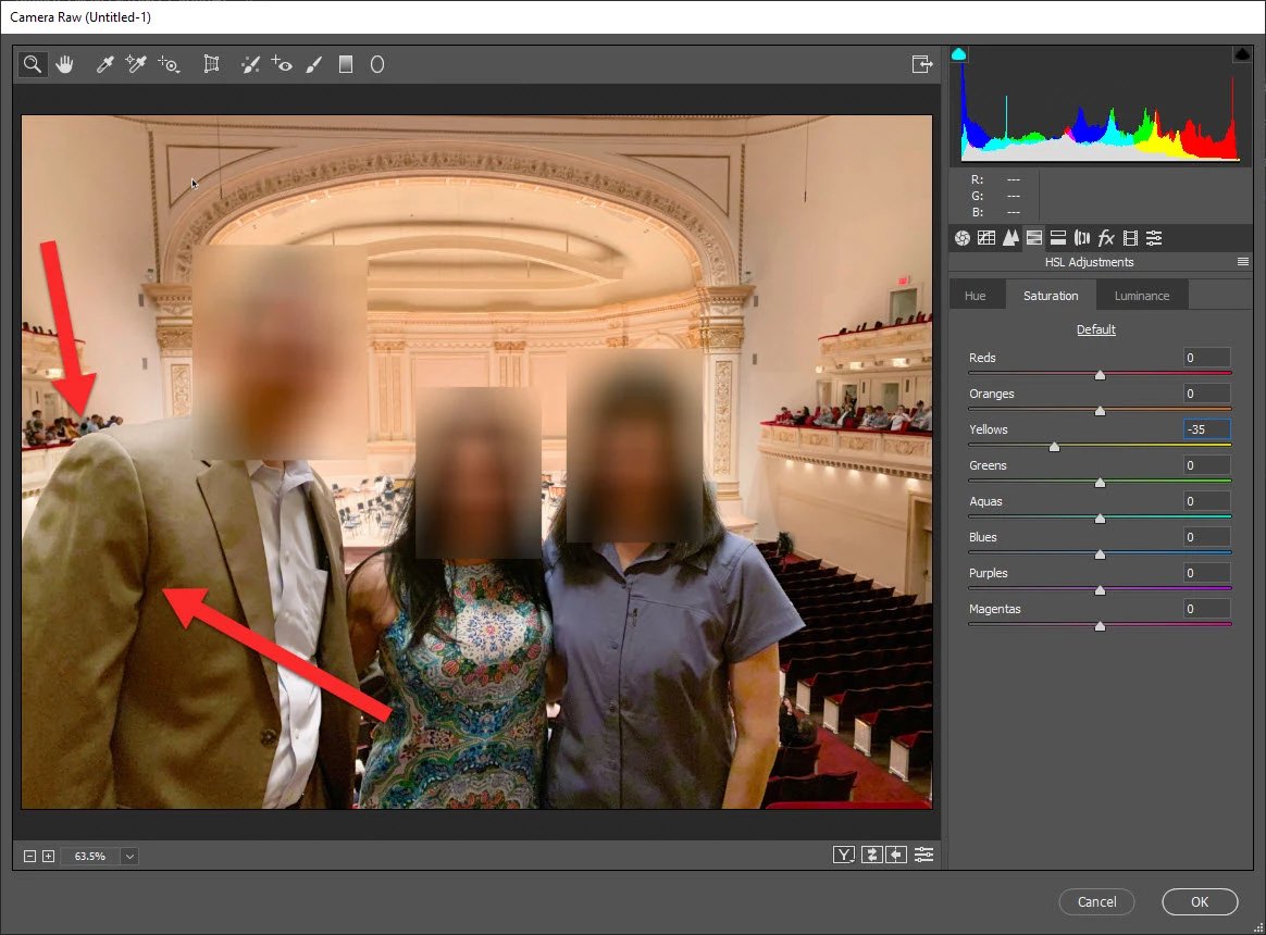

One of the easiest ways to remove the yellow is through Camera Raw. Go to Filter > Camera Raw Filter... and on the right side, below the histogram, in the icons, select the 4th icon from the left, which is the HSL Adjustments. Select the Saturation tab to reveal the sliders. Drag the Yellow slider to the right or enter a negative value to desaturate the yellow.
If you want to tweak it a little more, do the same for the Oranges to remove more of the yellow in the arm on the right.

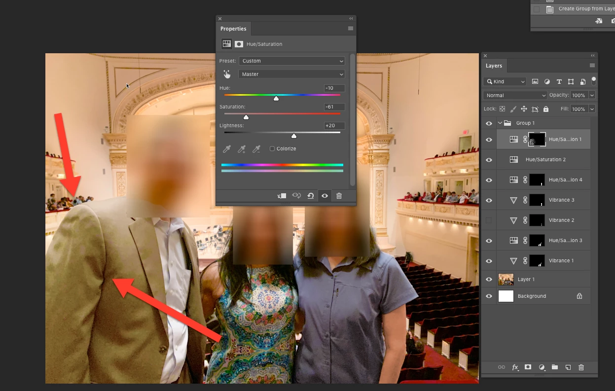

There are numerous ways to achieve the same result in Photoshop. My initial approach was to make a selection around the blazer, and then use the Color Range selection option to limit the selection to yellows and then create adjustment layers from that selection. I created both vibrance and hue saturation adjustment layers. There's an option in the Color Range section dialogue to select only yellows but I preferred to use Sampled Colors option and actually select the yellows in the image. I used the vibrance one to de-saturate and the hue saturation to add back in color but more consistently over the area. I did a similar process for the blazer, the blue shirt, and her arm. I'll include a screen shot for reference.

Jul 5, 2019 7:38 PM UTC
Myra has made a good suggestion. Try switching between luminance and saturation when using the yellow slider as the blue shirt on the right appears to have yellow overcast.
