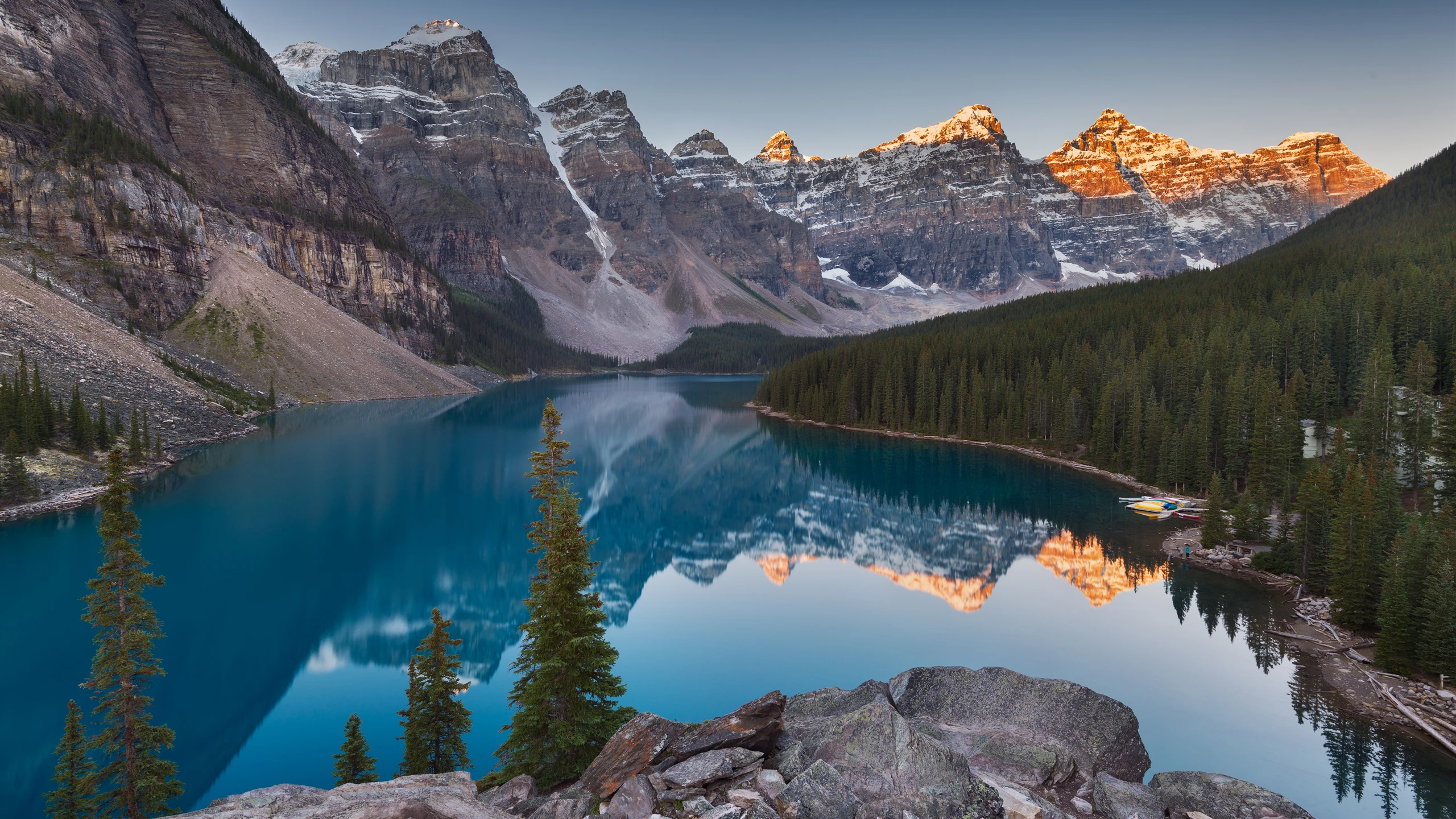

I have two identical images, by that I mean they are of the same subject. However one is brighter, with more contrast and saturation. I want to take this image and impose it over the other image and have photoshop calculate all of the curve differences so I can make a LUT. How do I do this?

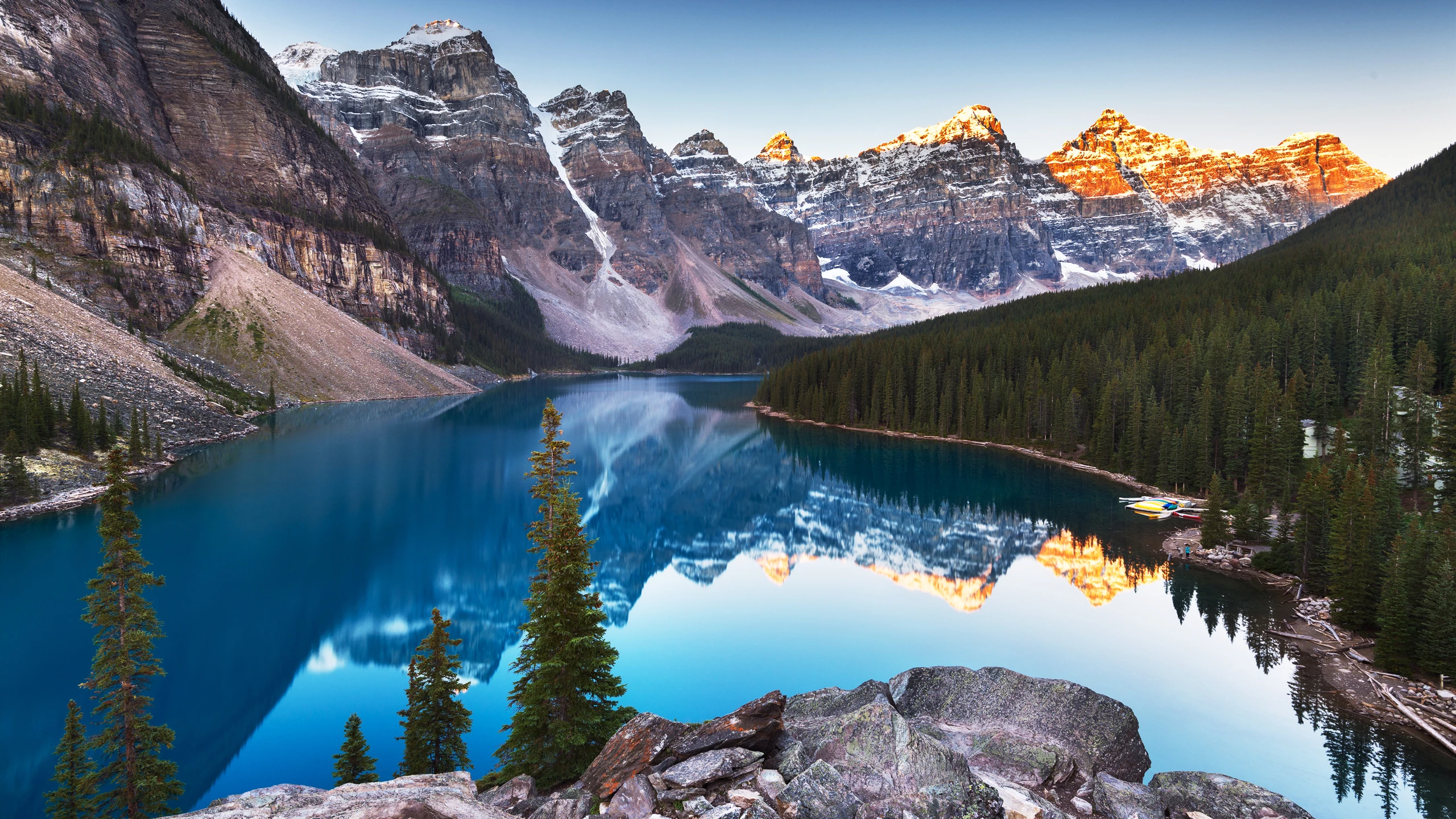

    Original is the Background copy. Copy to be corrected is Layer 1
    Highlight both layers and Edit > Auto Align Layers
    On the Original use the Color Sampler tool to mark 3 aim points. Note on a scrap paper the values shown in the Info Panel.
    Choose the Copy layer. The sampler positions are visible.

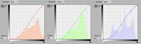

    Image > Adjustments > Curves. Cmd+Shift with the Sampler tool on the 3 aim points. Their values now appear in the Info Panel and their positions on the separate curves are marked
    Use the keyboard north/south arrow keys to move the curve point to the values marked on your scrap paper
    These are the Curves that produced the Copy above. Additional aim points may provide greater accuracy.
