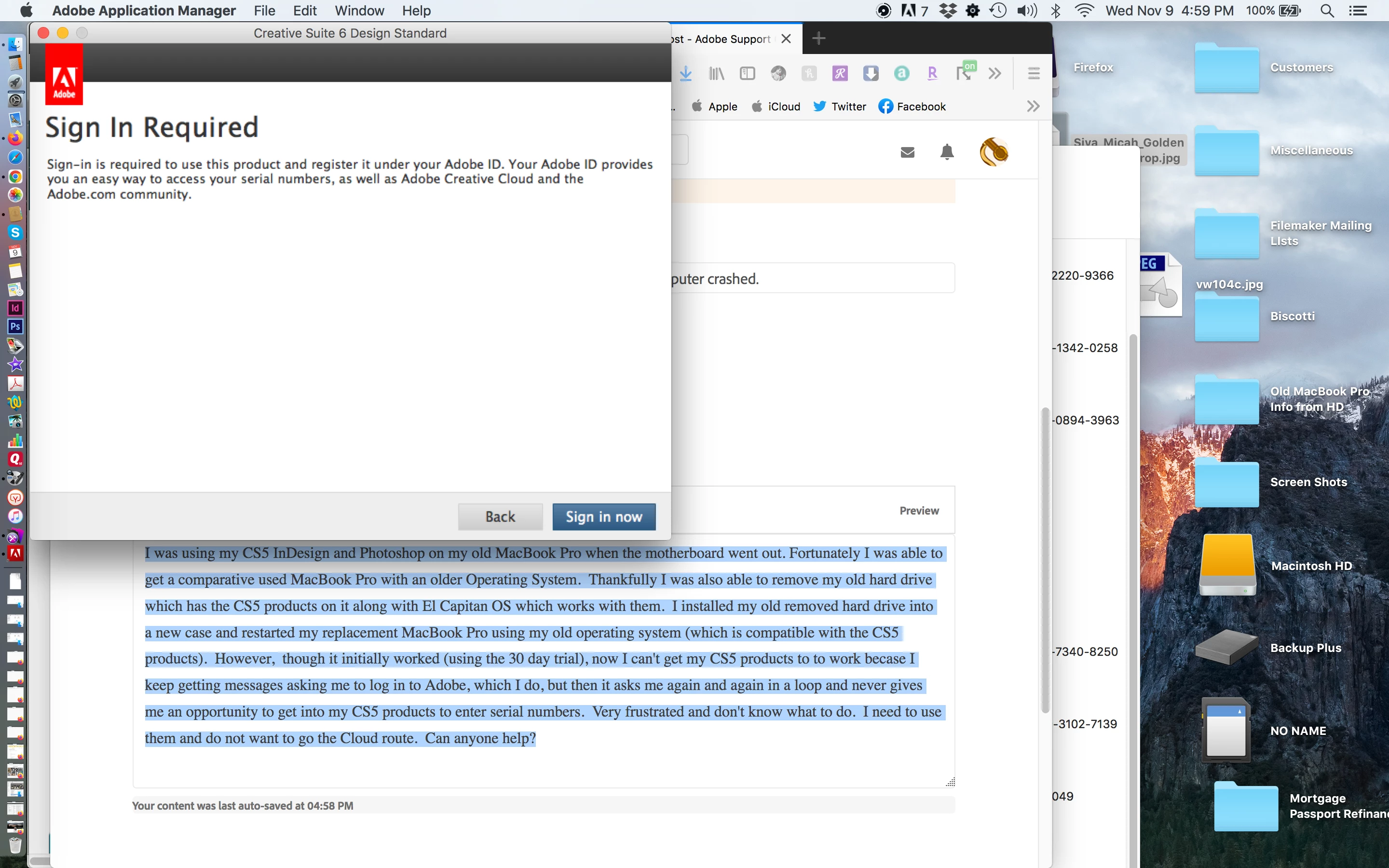

I need help using my CS5 products on a replacement MacBook Pro after my old computer crashed.
I was using my CS5 InDesign and Photoshop on my old MacBook Pro when the motherboard went out. Fortunately I was able to get a comparative used MacBook Pro with an older Operating System.  Thankfully I was also able to remove my old hard drive which has the CS5 products on it along with El Capitan OS which works with them.  I installed my old removed hard drive into a new case and restarted my replacement MacBook Pro using my old operating system (which is compatible with the CS5 products).  However,  though it initially worked (using the 30 day trial), now I can't get my CS5 products to to work becase I keep getting messages asking me to log in to Adobe, which I do, but then it asks me again and again in a loop and never gives me an opportunity to get into my CS5 products to enter serial numbers.  Very frustrated and don't know what to do.  I need to use them and do not want to go the Cloud route.  Can anyone help?

    John Waller
    Nov 10, 2022 2:05 AM UTC
    Out of curiosity, any reason your attached screenshot shows CS6 Design Standard while your post refers to CS5?
    vvprintsAuthor
    Nov 12, 2022 7:37 PM UTC
    My goof.  I meant CS6.  For some reason Adobe is only showing the CS5 in my list of products.  I have the original discs and serial numbers for the upgrade CS6 I bought.

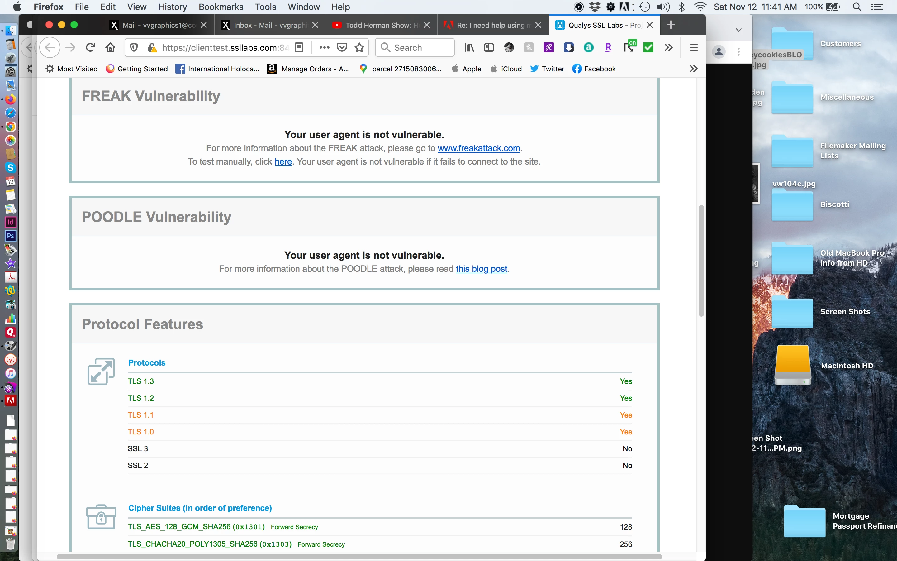

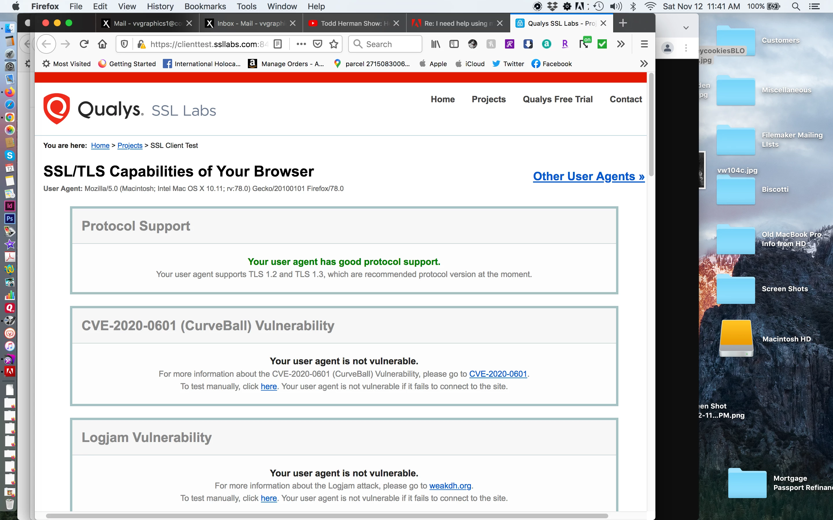

    John T Smith
    Nov 10, 2022 1:10 AM UTC
    TLS 1.2 is now required to connect https://helpx.adobe.com/x-productkb/multi/eol-tls-support.html
    -test your browser https://clienttest.ssllabs.com:8443/ssltest/viewMyClient.html
    -http://helpx.adobe.com/x-productkb/policy-pricing/activation-network-issues.html
    -https://helpx.adobe.com/download-install/kb/unable-to-reach-adobe-servers.html
    vvprintsAuthor
    Nov 12, 2022 7:45 PM UTC
    I don't want the Creative Cloud solution.  I want to use the CS software with an old OS on this computer.
