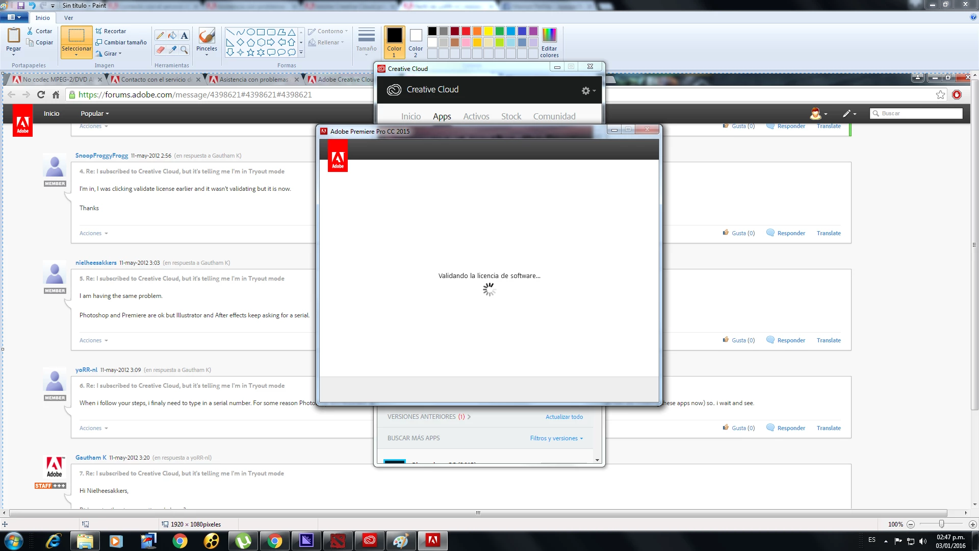

I click the license this software and this window  pops up  and then closes and opens  again.... in  the adobe cc it still shows premiere as trial...  help pls?
April 22, 2016
Could you fix tit? I have the exact same problem. It just keeps popping up even though I already validated the license.

Ahisap31589956 I would recommend utilizing the Host File fix option available in the CC Cleaner Tool.  You can download the tool at Use the Adobe Creative Cloud Cleaner Tool to solve installation problems .  For additional details I would recommend reviewing Advanced solutions to connection errors with Adobe Creative Cloud and Creative Suite applications  which has had several updates since this discussion was originally started.
