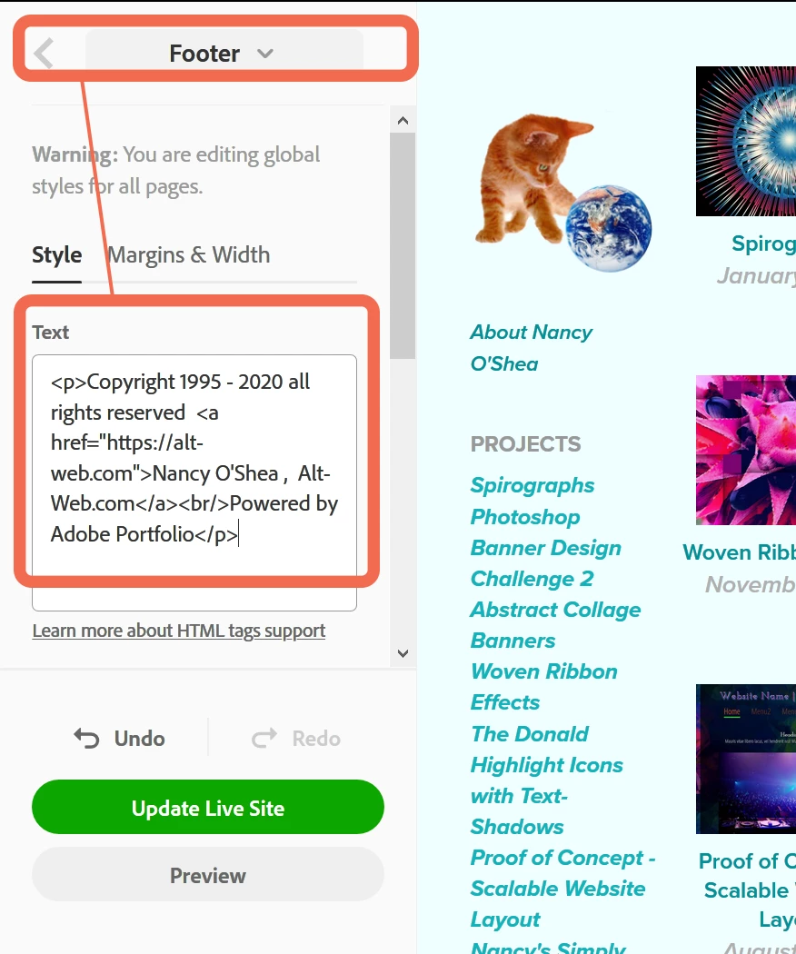

  1. Create a custom / project page containing your privacy policy.
  2. Update Live Site.
  3. Grab the privacy URL from browser's address bar (Ctrl + C)
  4. Open your sitewide Footer and add a bit of HTML code as shown below.
Your HTML link should resemble this.  Change URL accordingly.
<a href="https://yoursite.com/privacy_policy.html">Privacy Policy</a>
Post back if you have any questions.
