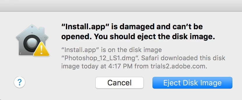

install.app is damaged
  • April 1, 2016
  • 1385 views
I'm trying to reinstall a older version of PS CS5 and when I download from adobe link I get an error message that Install.app is damaged and should eject. I'm unable to get any support from Adobe. Can anyone help?
    Correct answer gener7
    I was able to find the solution here: Illustrator CS5 re-install error: Install.app can't be opened.
    On terminal type:
    xattr -c /Users/******/Downloads/yourfilename.dmg
    It worked for me.
    You can also temporarily set "Allow Downloads from" to "Anywhere" and it will allow the install.  CS5 is "unsigned" and is blocked in the default security settings as an "unidentified" app.

    ‌Try downloading the installer again: Download Adobe Creative Suite 5 products
    rexall
    rexallAuthor
    April 1, 2016
    I've tried about 8 times with same results every time.
