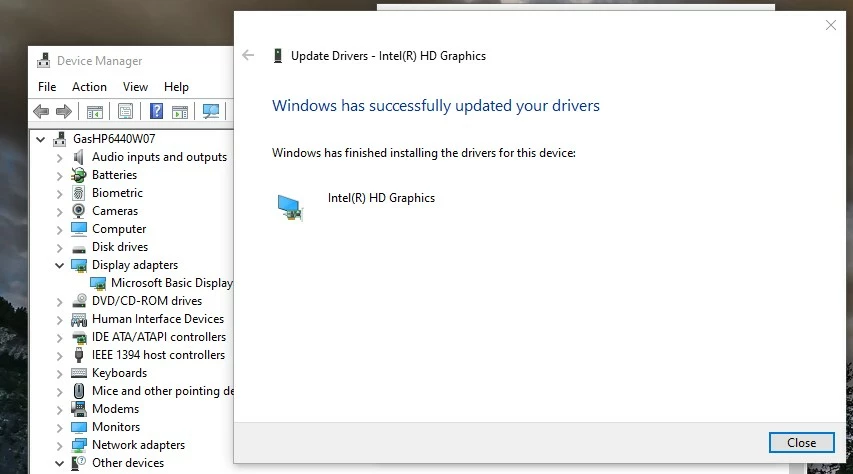

SOLVED: In the Cyberboy/Chamit post (see link bellow) , I choosed the DISABLE option but it didnt work, so with some fear, I tried the ROLL BACK option and it worked FINE, XD got installed!!!.
*** This is the original link from cyberboy and chamithw32649967 post...
https://steemit.com/tutorial/@cyberboy/i-found-the-solution-in-2-months-installing-adobe-xd-not-compatible-gpu-drive-fix
... Let me explain what I did from scratch:
Important: I have and use two monitors.
1) I activated just one monitor / now Second monitor is not working but still connected via RGB.
2) I went to Windows 10/ Device Manager / Display Adapter.
3) Under Display Adapter, I dissabled the Graphic Driver in the Driver Tab.
     a) I tried to install XD but it didnt work / same error about GPU blablabla ...
4) I pressed ROLL BACK button this time to go further.
     - My Laptop screen turned off but the second monitor got activated but with a poor resolution quality.
     - A Microsoft Basic Display Adapter got installed instead the original one.
5) I tried to install XD again and guess what? / ...  IT DID GOOD!
     - The istallation took a while but everything went fine.
6) I went back to Device Manager and choosed UPDATE DRIVER.
     - Pressed Automatic Search trying to get  back the original driver.
     - Windows located the original driver and it got installed normally. (in my case Intel HD Graphics)
     - My second monitor went off and the laptop screen turned on again.
7) I activated my second monitor through laptop functions keys.
😎 THE END!
Notes:
1) I was thinkin the installation error was my screen resolutin since my HP Pro6440B is just 1366 x 768 and the Min.Req according to Chamit post was 1280 x 800. But thanks god it was not the case 😉
2)  With one monitor I dont now! ... maybe I would have used safe mode or something like that to solve.
I hope it was useful, Gerald.

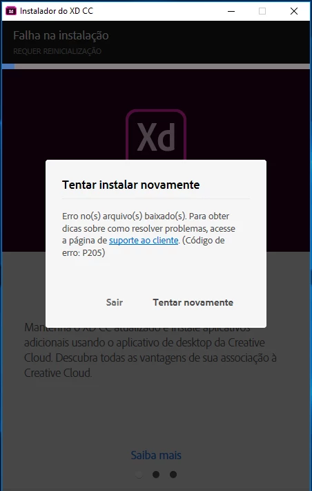

I am using the free version of Adobe XD on my Windows 10 laptop. I am trying to use it on a Windows 10 PC too, but I am not able to install. The problems are the same ones mentioned at the beginning of the topic.
I've tried to make the suggestions mentioned but nothing worked.
Anyone have any other ideas or news?
Error P205
Preran
Dec 10, 2018 2:27 PM UTC
Can you try the solutions in this discussion ERROR 205​ and let us know if they helped?

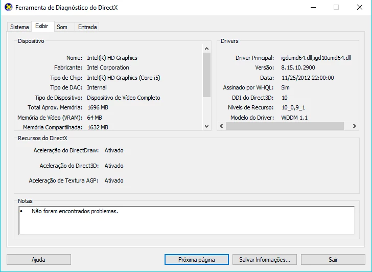

Oct 30, 2017 4:36 PM UTC
Hey Tiago,
For helping to us know us better can you please share a screenshot of your DxDiag panel?
Ankush
Battoni
BattoniAuthor
Oct 30, 2017 5:51 PM UTC
This image:
Thanks
ankushr40215001
Oct 30, 2017 7:39 PM UTC
Hey,
Thanks for reporting the issue, we have logged in a bug as it should have been worked for you.
Will update you accordingly.
Ankush
