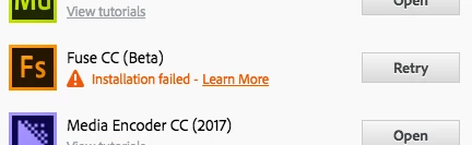

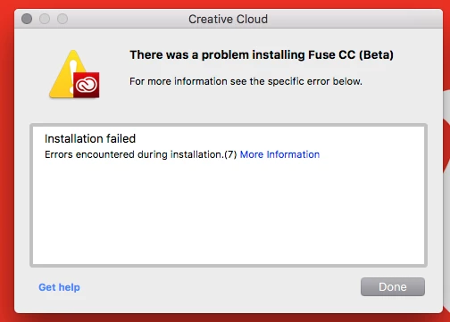

I figure this is the best place for me to post this, hoping that someone from Adobe will provide some guidance on my installation probs with Fuse (Beta).  Here's the rundown on my end:
I'm on Mac OS Sierra 10.12.5, and have the monthly CC subscription. Here are some screenshots of my error:

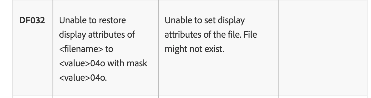

And then specifically this error code:
Exit Code: 7
Please see specific errors below for troubleshooting. For example, ERROR:
-------------------------------------- Summary --------------------------------------
- 0 fatal error(s), 1 error(s)
----------- Payload: Fuse CC (Beta) 1.0.0.0 {B57067F9-E97B-46EE-94F5-179373B81A6C} -----------
ERROR: DF032(Seq 1)
So then I looked up the DF032 part too:
And it meant nothing to me.
SO, here's what I have done/tried:
I looked up the Exit Code 7 specific instructions as found here: Errors "Exit Code 6" and "Exit Code 7" installing Adobe CS6, CS5.5, CS5, Premiere Elements, and Photoshop Elements and literally did every single thing on the list. Here is a brief recap of what I have done:
  • Renamed Adobe Folders in the Applications folder. I was figuring that by doing this, it would force the install to create NEW folders, but I did not see any new ones appear.
  • Restarted my computer.
  • Signed out of CC and back in.
  • Uninstalled Adobe AIR and then reinstalled it.
  • Tried to find the installation log, but cannot find one in the logs folder specific to Fuse.
  • Changed all the folder permissions to Read and Write for the appropriate Adobe folders and their contained folders.
Any thoughts are welcome!

Audiovisualboy Exit Code 7 errors occur due to file permission failure.  If you have implemented all of the steps listed in Errors "Exit Code 6" and "Exit Code 7" installing Adobe CS6, CS5.5, CS5, Premiere Elements, and Photoshop Elements​ then the next step is to attempt the installation under a newly created local administrator account.   Details on how to set up a new local administrator account can be found at Install or run Adobe applications in new user account | Mac OS X​.
If you continue to receive Exit Code 7 errors, when installing Fuse CC (Beta) on macOS Sierra 10.12.5, after logging in under the newly created account then review the settings of any installed security software.  It is possible that security software may be denying the required access for the installation to occur successfully.
June 16, 2017
I want to thank you very much. This simply workaround did the trick.
