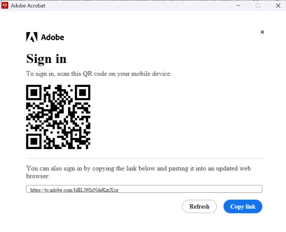

    I have used the removal tool and restarted. I then reinstalled Acrobat_2017_Web_WWMUI, entering my serial number, which is accepted. It installs fine.
    Upon launch, it first tries to load, then crashes.
    Upon second launch, I get a sign in screen.
    I click Sign in now.
    A popup appears with
    “Sign in
    To sign in, scan this QR code on your mobile device.
    You can also sign in by copying the link below and pasting it into an updated web browser:https://to.adobe.com/lsBLJ6SzNdeKmXcg
    RefreshCopy link”
    If I scan the QR code on my phone, it loads the sign in page and I enter my login and password. Then I just see a white screen with a spinning blue circle and nothing happens.
    If I paste the URL into my browser, it just takes me to the home screen (https://www.adobe.com/home?mv=other&promoid=LLVYT1CM), where I am already logged in.
    I cannot get any further than this. Please note, I only have this standalone product, not a subscription.

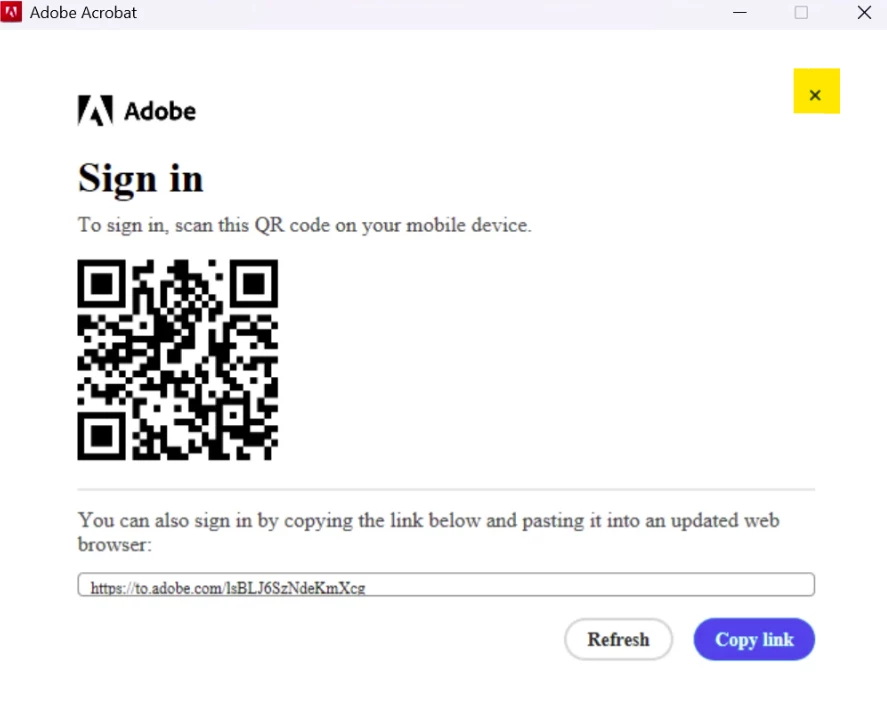

    Meenakshi Negi
    Jun 23, 2026 5:45 PM UTC
    Hi Petrat81,
    Thank you for the screenshots and sharing the information.
    Did you try to click on “X” the window where you get the QR code? If not, please try and let us know what happens. Check the screenshot below for reference.
    Let us know how it goes.
    Meenakshi

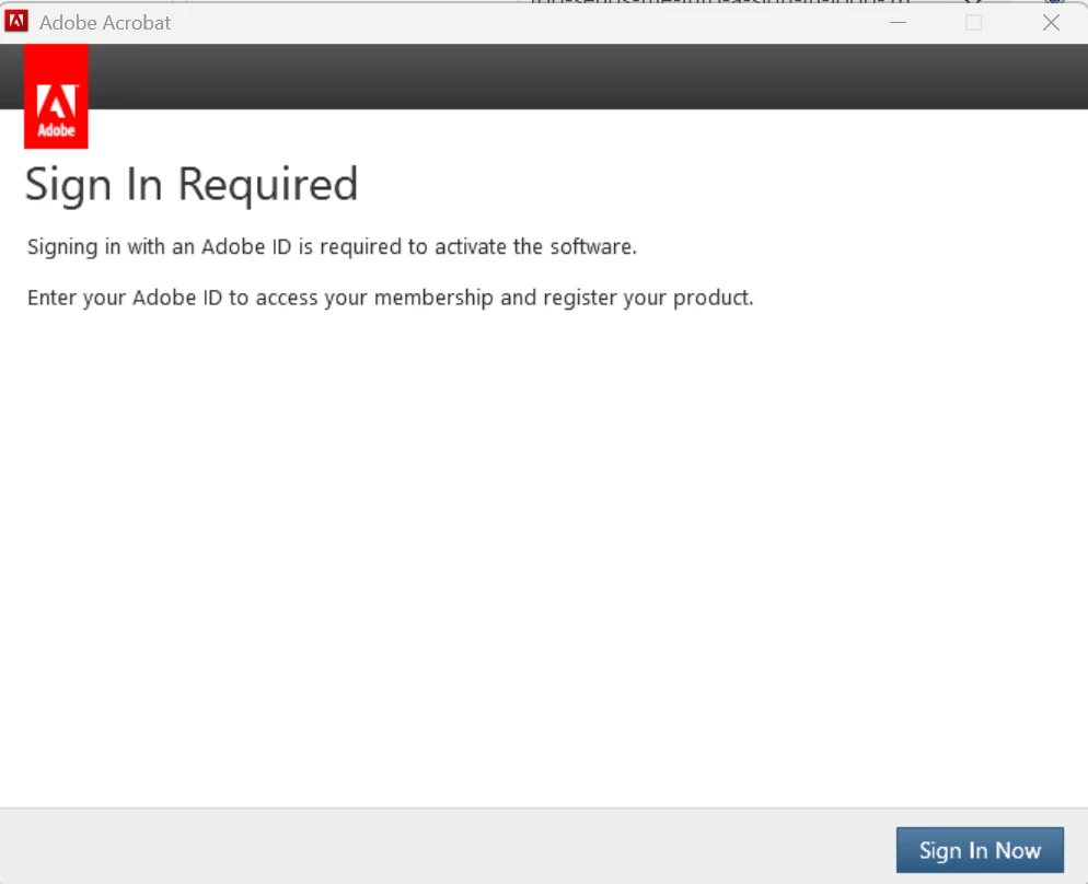

    Petrat81
    Petrat81Author
    Jun 23, 2026 5:49 PM UTC
    Yes, it closes the window and respawns the “sign in required” window.
