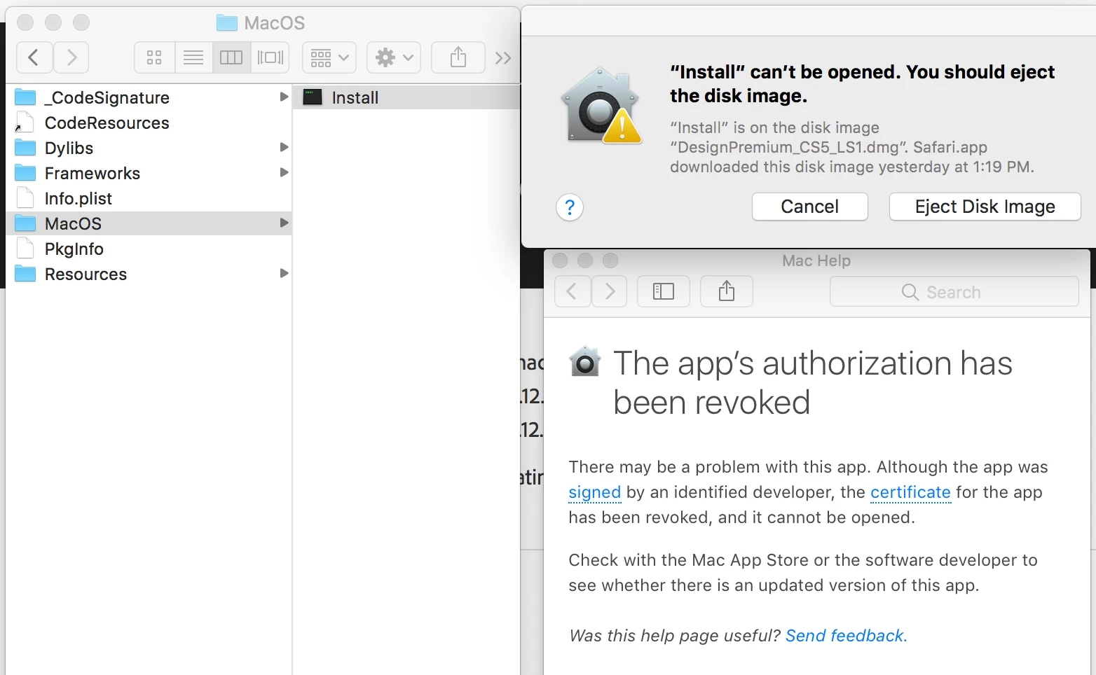

When trying to install my CS5 apps onto a machine running Mac OS Sierra I get the following error message:
The app’s authorization has been revoked There may be a problem with this app. Although the app was signed by an identified developer, the certificate for the app has been revoked, and it cannot be opened. Check with the Mac App Store or the software developer to see whether there is an updated version of this app. Was this help page useful? Send feedback.
I have tried following the steps at https://helpx.adobe.com/creative-cloud/kb/install-creative-suite-mac-os-sierra.html but still received the same error.

May 19, 2017
Here's a screen capture of the error message. On the left is the finder window showing the package contents from the install download. The "Install" file is the file I believe the instructions refer to. When I attempt to open the "install" file with Terminal, the error message in the upper right appears. Clicking on the question mark on that message brings up the help window describing the authorization issue.

Thanks for the update Michelt80602532.  Good job locating the Install Unix Executable.
As discussed in Installing Creative Suite on macOS 10.12 (Sierra) you will now want to drag the Install Unix Executable to an open Terminal window.
The Terminal can be found in the Utilities folder.  Once open drag the icon to the open window.  You will then want to follow the instructions in the terminal window to begin the installation process.

Michelt80602532 if you are still receiving error messages about the application's authorization being revoked then please make sure you are following the steps listed at Installing Creative Suite on macOS 10.12 (Sierra) .  You would receive the message only if attempting to double click or open the installer.
You need to make sure to open the application package and locate the Install Unix Executable.  Once located you have to drag it to the open Terminal window.
If you continue to face difficulties then please post a screen shot of the error you are receiving.   You can find details on how to post a screen shot at FAQ: How do I capture and post a screen shot or video?​.
