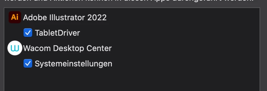

Thanks. But i the mean time i wrote with costumer support and asked them for a 2020 version of Ai. So i got one.
After just installing it (without deinstalling the other one or whatever … nothing fancy. Both Ai version on my system now) it just worked.
Ai 2022 is now(!) listed in the automation settings in my macOS security settings and everything seems to work like it should.
I can imagine that it still would work when i now deinstall Ai 2020 … but i dont want to risk it.
