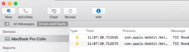

    lynncp, you could try the trial install again, but first open Console, which is here:
    /Applications/Utilities/Console.app
    Open that first, select the Errors and Faults option, then Clear, before running the trial install. It may show some useful errors that are going on. Here's a screenshot of it:
