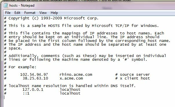

I systematically implemented each of the recommended fixes:
-  Verified I'm connected to the Internet (obviously)
-  Verified I can access secure sites
-  Checked "hosts" file, verified I have access to activation servers for CS6 or later (but not for not CS5.5), but in attempting to reset the hosts file, did not find any references to "activate.adobe.com.  Here's what I saw:
-  Verified that the GlobalSign Root CA certificate is enabled ("enabled only for the following purposes") and did not change any of the checked boxes in the list.
After taking all these steps, the situation remains the same- blank Creative Cloud App.
Any further suggestions?
