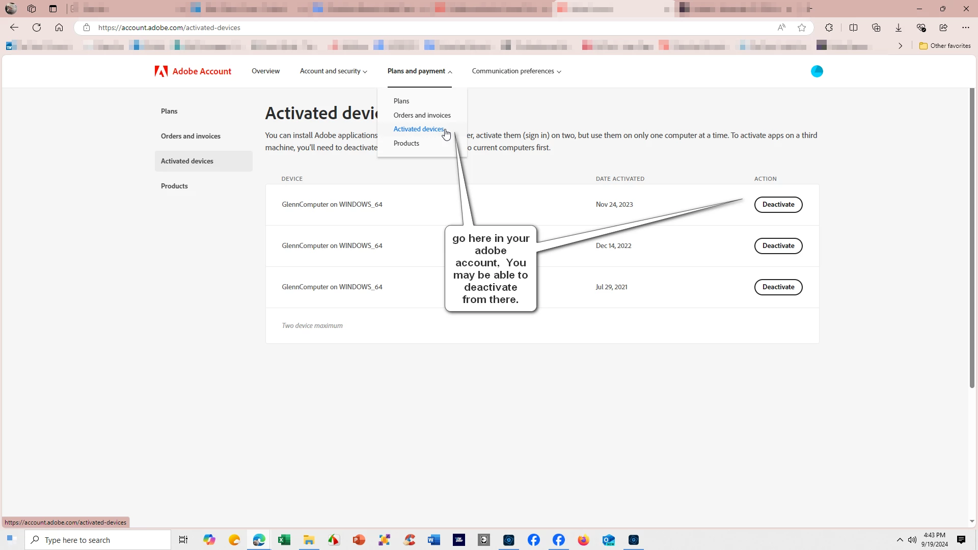

Glenn 8675309
Sep 19, 2024 11:45 PM UTC
Try this, it may work isnce you have pse 2024.
Peru Bob
Sep 19, 2024 11:53 PM UTC
@Glenn 8675309
That only works for Creative Cloud apps, not perpetual versions.
