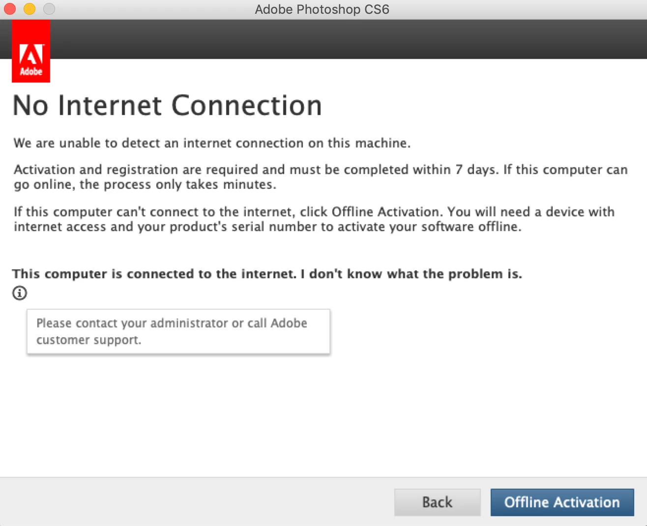

Hi. I have a problem activating PS CS6.
I was replacing the SSD in my Macbook Pro. Before replacing, I uninstalled PS CS6. After replacing it, I can't reinstall CS6
I bought a PS CS3 first and then a PS CS6 as an upgrade. I have 2 codes to activate.
After uploading PS CS6, I entered the upgrade code. A message appeared in the window that the code was invalid. Unfortunately, you cannot re-enter the code, because the Adobe window says that I am not connected to the Internet, which is not true.
In the chat, Adobe employees did not explain anything.
Please help.

Hi again.
Reinstallation was successful.
I called a foreign (as it turned out) hotline (I hope it's true that it is free hotline 😉 ), where a consultant from India explained to me, or maybe understood already during the activation of CS6, that online activation is no longer possible.
He said the activation process would be complicated and asked to be able to remotely control the computer. For this purpose, they send a program that runs, as the consultant said, for the duration of the session.
I defended myself, but finally agreed.
After an unsuccessful online activation attempt, the consultant went to offline activation. For some reason, it was also not easy. The first time, the consultant also received an request code error.
On the second try it was successful.
After completing the activation, the consultant sent me instructions on how to go offline activation by yourself. I am pasting these guidelines here. I know a link has been provided for how to do this, but maybe someone would need some other words to explain.
"Greetings from Adobe!
This email is regarding the conversation we had for the CS6 Activation. Here I am sharing the offline activation steps to activate the application below:
< Launch the product.
1). At the Serial Number Validation screen, click Having Trouble Connecting To The Internet.
2). Click Offline Activation and click Generate a Response Code.
3). Write down the Request Code.
4). Switch to an online computer and navigate to
 www.adobe.com/go/getactivated
5). Click Offline Activation.
6). Sign in with your Adobe ID.
7). Enter your Request code and click Generate.
8). Write down the Response code.
9). Switch back to the offline computer.
10). Enter the Response Code and click Activate."
The only thing that is not clear to me is step 3). How the consultant got the request code?
The offline PS CS6 activation procedure is so complicated that it's nice if Adobe released a video tutorial.

cs6 is no longer supported by adobe, but it is available and it still can be activated.  but to activate (during the installation process), you must contact adobe's secure servers.
there are a number of things on your computer and/or network that could prevent that and trigger the error you posted in your first message.
confirm that you can connect to the secure adobe servers by reading, http://helpx.adobe.com/x-productkb/policy-pricing/activation-network-issues.html
do you see both logos (after clicking the test link)?
if you can and still see a connection error try these steps, https://helpx.adobe.com/download-install/kb/common-network-connectivity-issues.html
if those all fail, white list the adobe network endpoints, https://helpx.adobe.com/enterprise/kb/network-endpoints.html

I see both logos.
I checked my settings on MacOS. All incoming connections are allowed.

Regarding offline activation :
1. I dont understand what is machine request code that I have to write on the left. How can I receive it?
2. Which serial number I should write first,  of CS3 or of upgrade to CS6
Oct 10, 2022 9:52 PM UTC
I pressed "generate response code" and an "invalid request code" alert appeared. I also used serial number of upgrade to CS6

Hi @Robert26515915t4pl, I'm sorry to hear about the trouble. How did you try to install CS6 after replacing your SSD? From a download link or physical disk? If you have registered or purchased your Creative Suite app from Adobe, you may be able to download CS6 from your account. You need your serial number, not only the upgrade code. Check this help page (Last updated on Aug 3, 2022) for more info: https://helpx.adobe.com/creative-suite/kb/cs6-install-instructions.html.
Oct 10, 2022 8:02 PM UTC
At the beginning, I wrote that I bought a PS CS3 and an upgrade to PS CS6. Purchase from the official distributor in Poland. Unfortunately, it no longer exists. Of course, I have both versions on DVD. I also have the original 2 passwords. I was installing the program from PS CS6 media. Until now, Adobe, after entering the password to upgrade to CS6, asked, then for the password to CS3. Now, after entering the password to upgrade to CS6, I immediately got a message that the password is incorrect. After that, the message in the Adobe window that the computer is not connected to the Internet is displayed all the time, which is not true. Ultimately, Adobe reported that my password was invalid or expired, and then that it was being distributed illegally. I am the first and only owner of a CS3 license and an upgrade to CS6. I did not share the password with anyone. I would like to add that I have registered the product and currently Adobe states that the version with my license is not used anywhere. Adobe is not responding, just urging you to buy a subscription for new versions. It looks bad.
