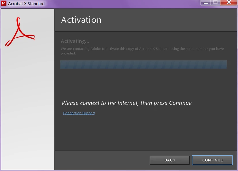

Jul 27, 2024 10:58 PM UTC
" click Having Trouble Connecting To The Internet."
This option does not appear, as the screenshot I attached will show.  The Connection Support link opens a page about diagnosing internet connection.

then you have a tougher task.
reconnect to internet.  adobe connection errors are common and are not related to whether you're connected to the internet.  they're related to connecting to adobe's secure servers.
if you have a non-current os, your default browser must support tls 1.2, https://helpx.adobe.com/x-productkb/multi/eol-tls-support.html
to test your default browser's tls you can use , https://clienttest.ssllabs.com:8443/ssltest/viewMyClient.html
otherwise, confirm that you can connect to the secure adobe servers by reading, http://helpx.adobe.com/x-productkb/policy-pricing/activation-network-issues.html
do you see both logos after clicking "link"?
if you can and still see a connection error try these steps, https://helpx.adobe.com/download-install/kb/common-network-connectivity-issues.html
if those all fail, white list the adobe network endpoints, https://helpx.adobe.com/enterprise/kb/network-endpoints.html
or, if you’re trying to activate a perpetual license, you can try offline activation by disconnecting your computer from the internet, starting activation and using https://aoes-stage.licensingstack.com/aoes/aoes/v1/imsauthstatus
