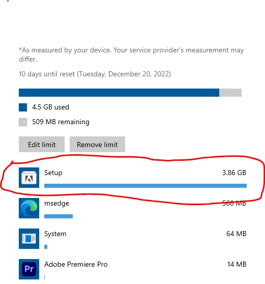

Dec 10, 2022 9:35 AM UTC
I think I have the same issue !! It's using up all my data. Someone please help.
I think this started after my CC displayed an available update. I didn't update and it keeps trying to do so but fails.

Dec 11, 2022 5:42 PM UTC
Thank You so much ! I updated Premiere and the problem stopped. I think when an update run fails and re runs it downloads the update every single time.
