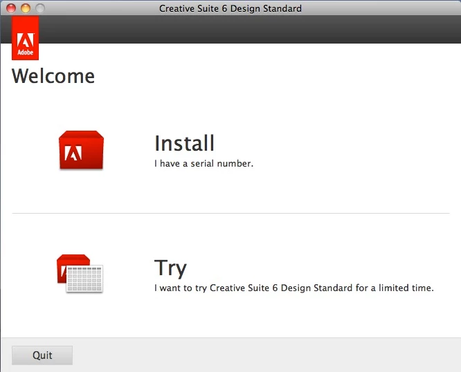

1. leave your WiFi off, i.e. no internet connection. Click on Install (I have a serial number)

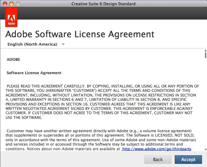

2. Accept the SLA

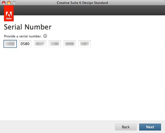

3. Enter your serial number and click Next

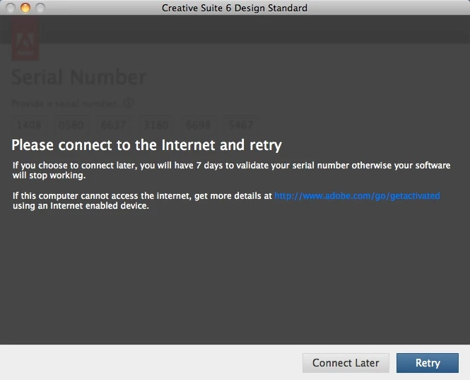

4. The Error Message appears. Do not panic. Click Connect Later

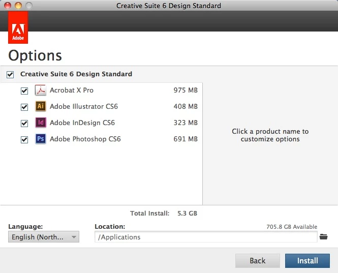

5. Select Options (including Language option) and click Install

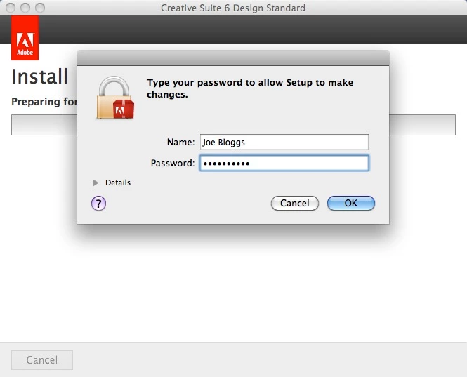

6. Enter Administrator credentials and click OK

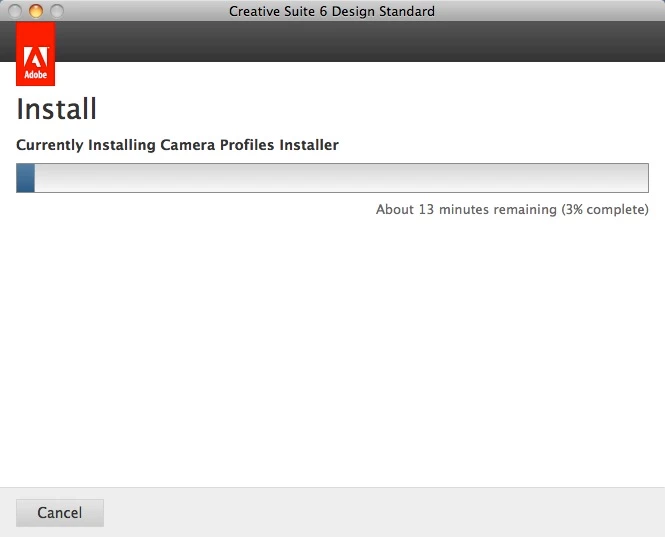

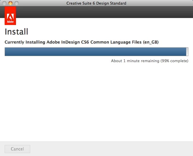

7. Install starts …
8. … and finishes ...

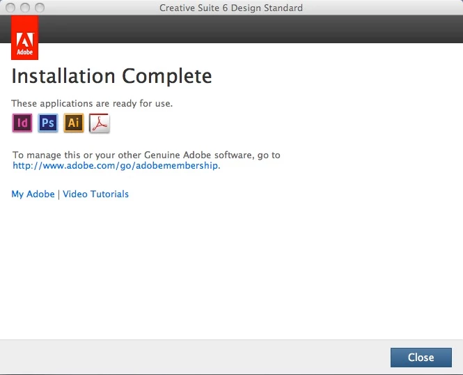

9. … with Installation Complete. Click Close

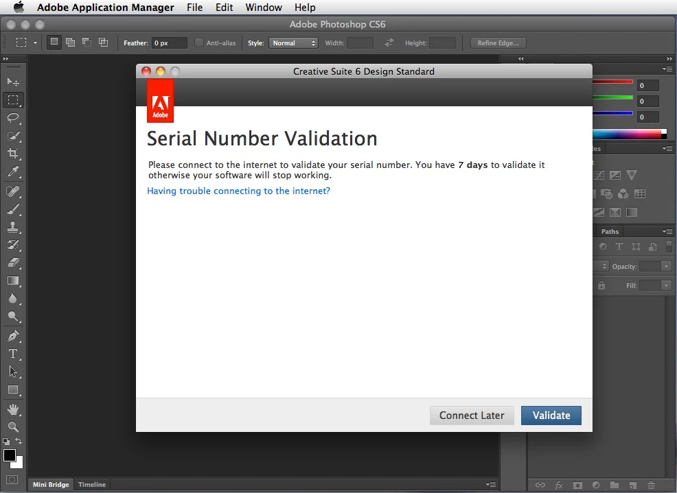

10. Open one of the CS6 applications (Photoshop in this example)
11. Click on Having trouble connecting to the internet? A window should pop up with a Request Code. Copy this to your Text Edit document and send that to your internet connected computer. NOTE: If the ‘Serial Number Validation’ window does not pop up automatically, go to Product Registration in the drop down Menu Bar Help Menu

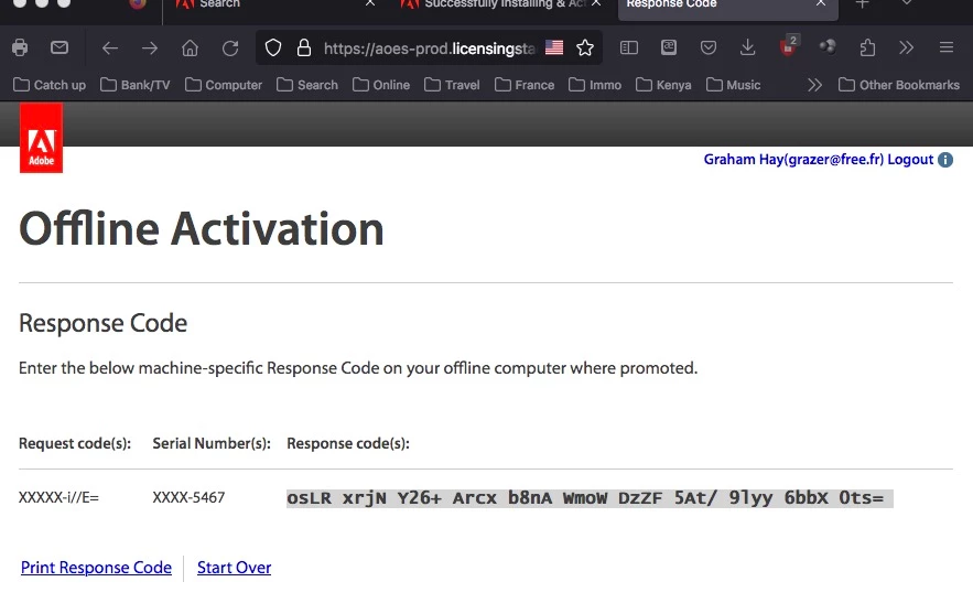

12. Now change computers. On the internet capable computer go to http://www.adobe.com/go/getactivated. On the ‘Offline Activation’ page click on Generate a Response Code. You will be required to enter the Request Code and the CS6 serial number. You can Copy&Paste the Request Code from your Text Edit document.
IMPORTANT NOTE: the UK Install DVD tells you to go to https://www.adobe.com/go/getactivated_uk. It leads to a dead end because that page cannot be found. Remove _uk from the end and it will work.
13. All being well, a Response Code is generated. Copy this to your Text Edit document and send that back to the OS 10.6 computer.

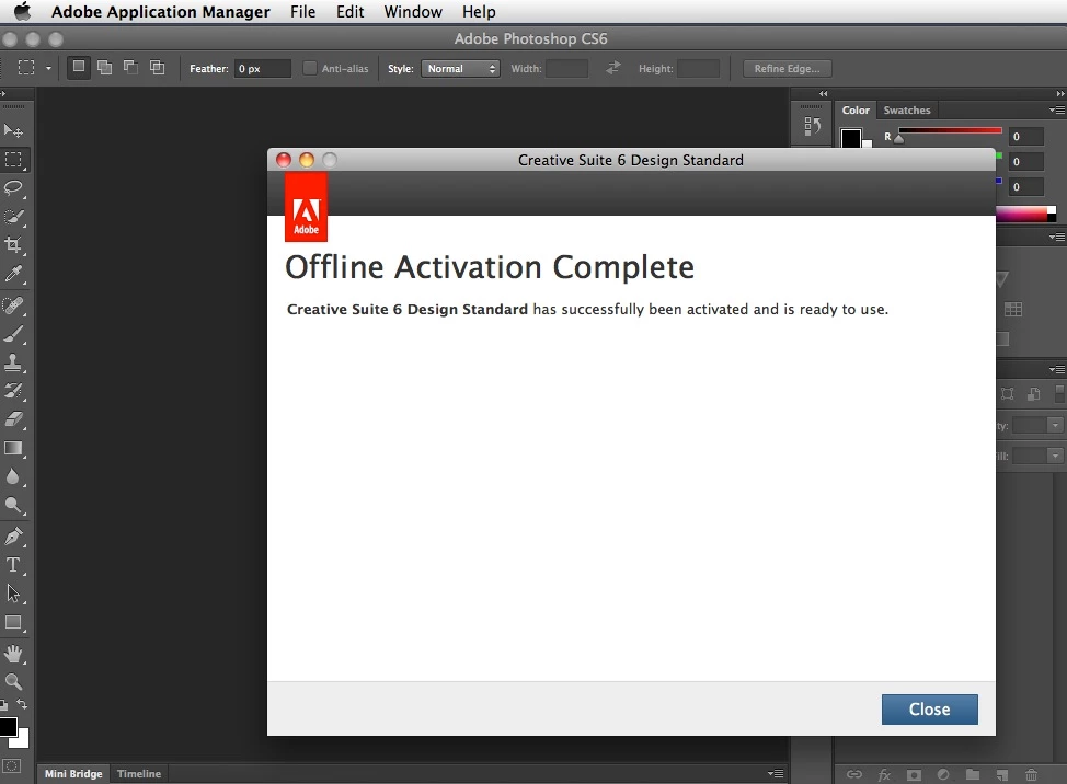

14. The Offline Activation window is still waiting to be completed. Copy/Paste the Response code from your Text Edit document into the Response Code field ...
15. ... and if the Gods are on your side you will see Offline Activation Complete.
