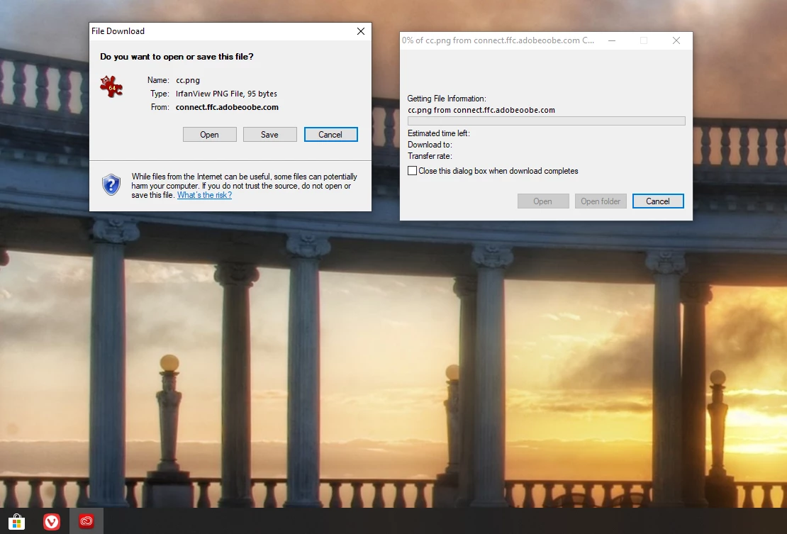

1. The download is from a server in the adobeoodb.com domain. This could be a fake, since it isn't adobe.com, so let's check. https://helpx.adobe.com/uk/enterprise/kb/network-endpoints.html shows the Adobe servers you need to unblock to make things work. adobeoobe.com is in there. So this is a genuine Adobe server.
2. The downloads variously say "Infanview PNG file" or "ACSee ... PNG file". This is not saying these apps are in any way involved. This is just what, on your system, Windows calls PNG files. The name comes from the default PNG handler, and you'd get it whenever you download (rather than display) a PNG file. So, all we know is, it's a PNG file and is being downloaded.
That's all so far. So it points at a technical glitch somewhere, but not an attack. As noted above, one pixel images are frequently used as counters, but that clearly isn't what's happening.

I don't have any ACDSEE products installed, and FreeDownloadManager which handles my downloads suddenly downloaded this cc.png, from https://connect.ffc.adobeoobe.com/cc.png?t=1565191975033
Contents, (leaving out non-ASCII characters) are identical to those posted by AranankA above. Creative Cloud (4.9.0.504) is running but did not react to this download. No Adobe pages open in any browser.

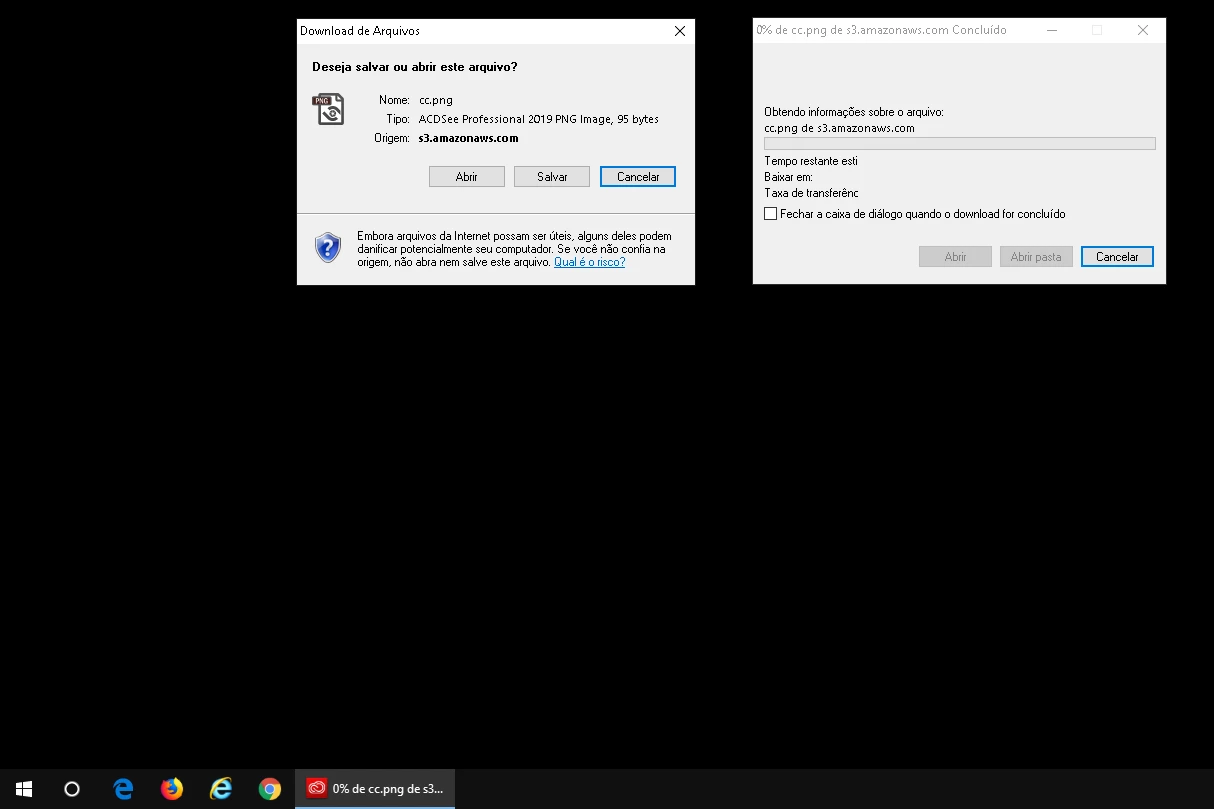

David__B
Apr 8, 2019 10:41 PM UTC
Hi Marcelo,
This doesn't look like it is Adobe related it looks like ACDSee Pro. ACDSee Photo Studio Software | Photo Editing, Photo Management, Photo Editor, Digital Photography, Digital Asset Managem…
You should contact them for help.

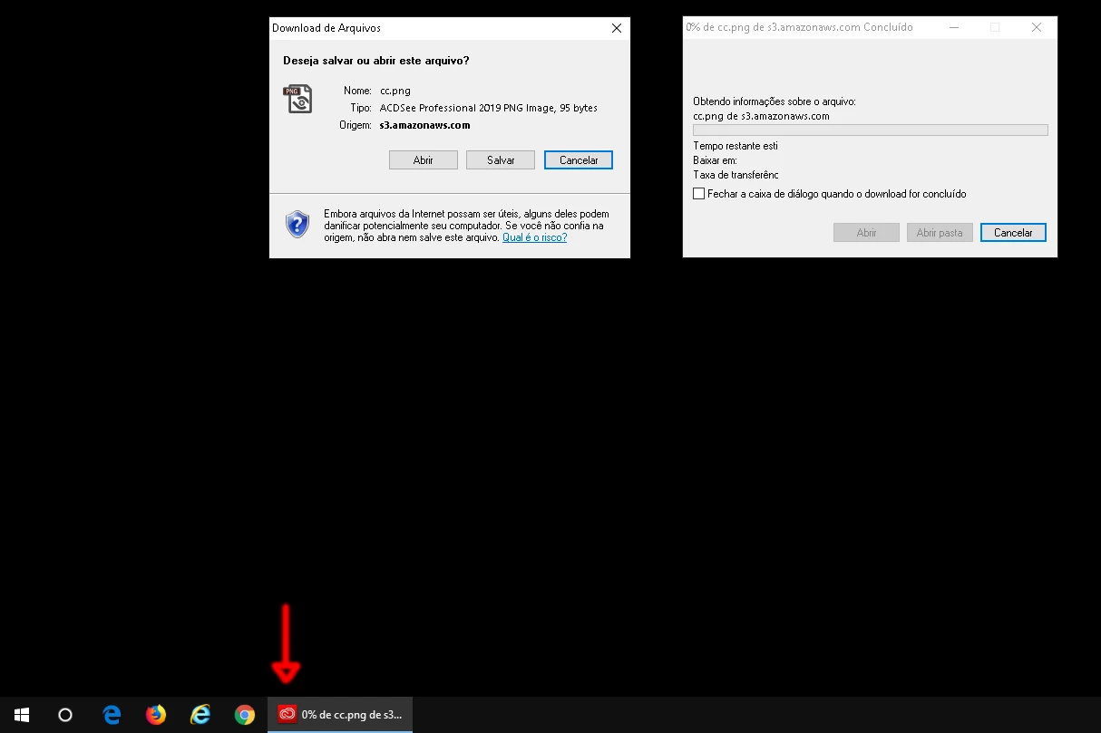

Marcelo Dischinger
Apr 8, 2019 11:16 PM UTC
ACDSee Pro is just the software configured to open image files. It could be any other. The pop-up message icon is from Creative Cloud (see attached image).
