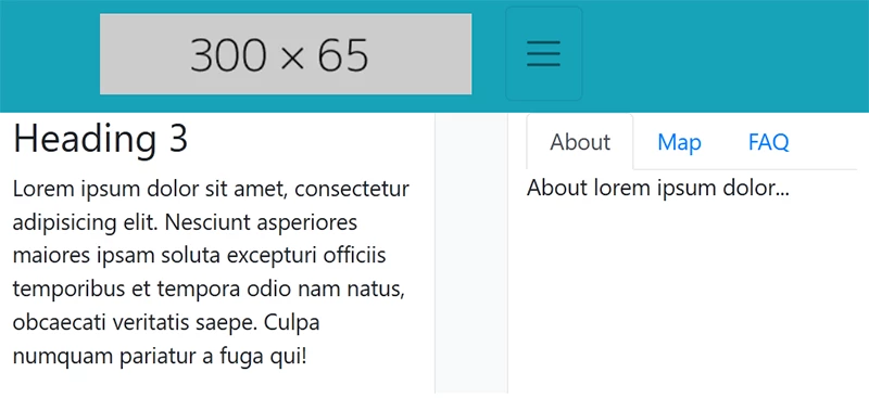

Nancy OShea
Jun 13, 2022 11:38 PM UTC
Answers to layout questions are contained in your code, not the code on CodePen.
Tabbed Panels inside columns with Bootstrap which uses Flexbox.

<main class="container-fluid">
<section class="row">
<div class="col-6">
<h3>Heading 3</h3>
<p>Lorem ipsum dolor sit amet, consectetur adipisicing elit. Nesciunt asperiores maiores ipsam soluta excepturi officiis temporibus et tempora odio nam natus, obcaecati veritatis saepe. Culpa numquam pariatur a fuga qui!</p>
</div>
<!--column spacer-->
<div class="col-1 border-left border-right bg-light">
</div>
<div class="col-5">
<!--TABBED PANELS-->
<ul class="nav nav-tabs" id="myTab" role="tablist">
<li class="nav-item" role="presentation">
<a class="nav-link active" id="about-tab" data-toggle="tab" href="#about" role="tab">About</a>
</li>
<a class="nav-link" id="map-tab" data-toggle="tab" href="#map" role="tab" aria-controls="profile" aria-selected="false">Map</a>
</li>
<a class="nav-link" id="faq-tab" data-toggle="tab" href="#faq" role="tab">FAQ</a>
</li>
</ul>
<div class="tab-content" id="myTabContent">
<div class="tab-pane fade show active" id="about" role="tabpanel">About lorem ipsum dolor...</div>

I don't think we know what you mean by 'will not page' in any multi column layout?
Can you post your code here as that will give us a better idea of what you are trying to do?
I'll check back tomorrow as its now late here in the UK.
Jun 14, 2022 12:55 AM UTC
by "will not page"  I mean that the correct page content does not display based on the menu item selected.
