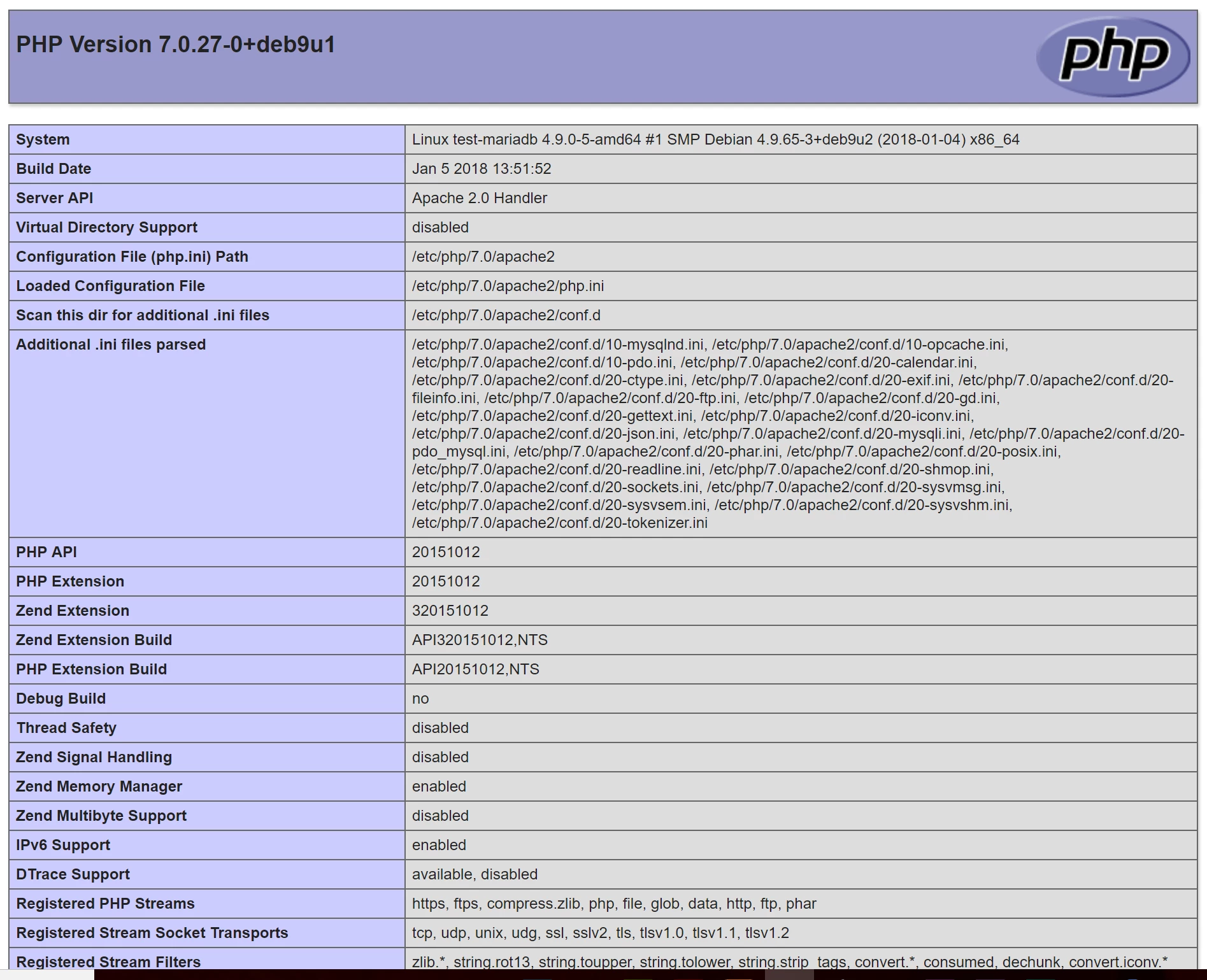

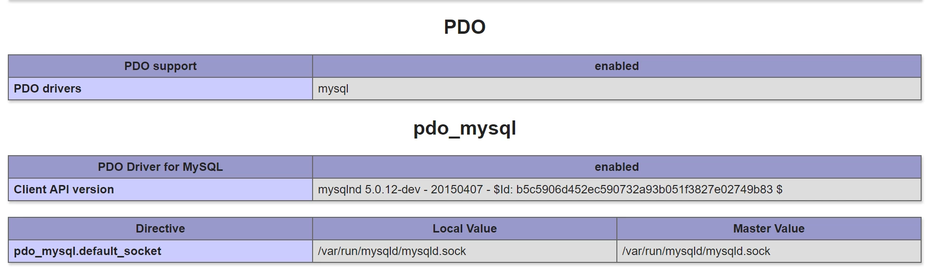

RR456Author
Feb 12, 2018 5:30 PM UTC
Thanks for the reply Ben.
Something must be side-ways on the server I spun-up at GCE since my connection script is still not working and I have very limited skills as a System Admin.
I've included below 3 screen shots that I believe show I have PDO enabled and the extension=php_pdo_mysql.dll activated.  In addition, I changed the script from 'localhost' to '127.0.0.1', restarted Apache from the command line (pretty sure) limited "flight time" on a command line, still no connection.
Any other suggestions would be appreciated; but, like I say maybe it's not the script but the server set-up that's not letting PDO interface with MariaDB.
