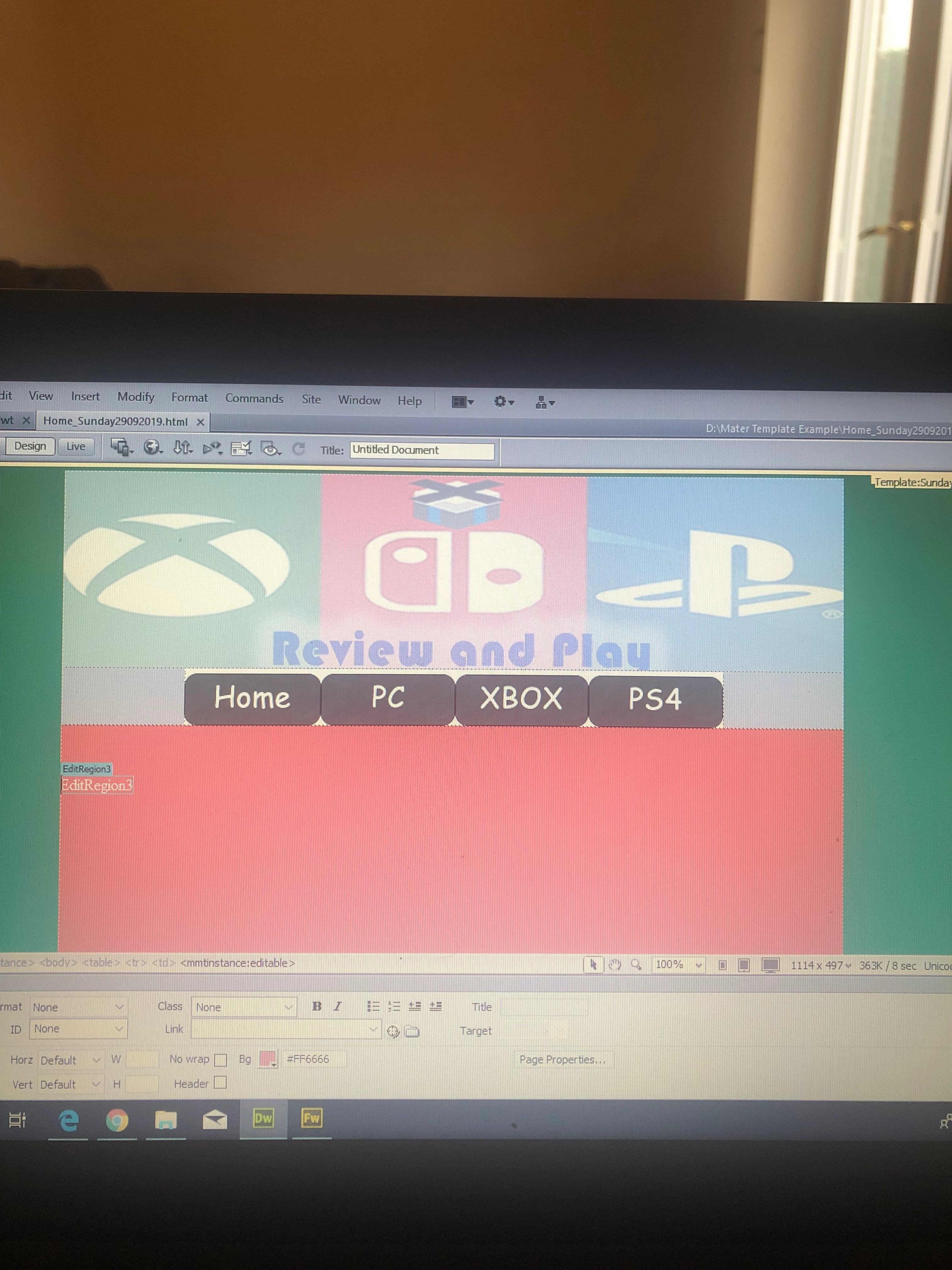

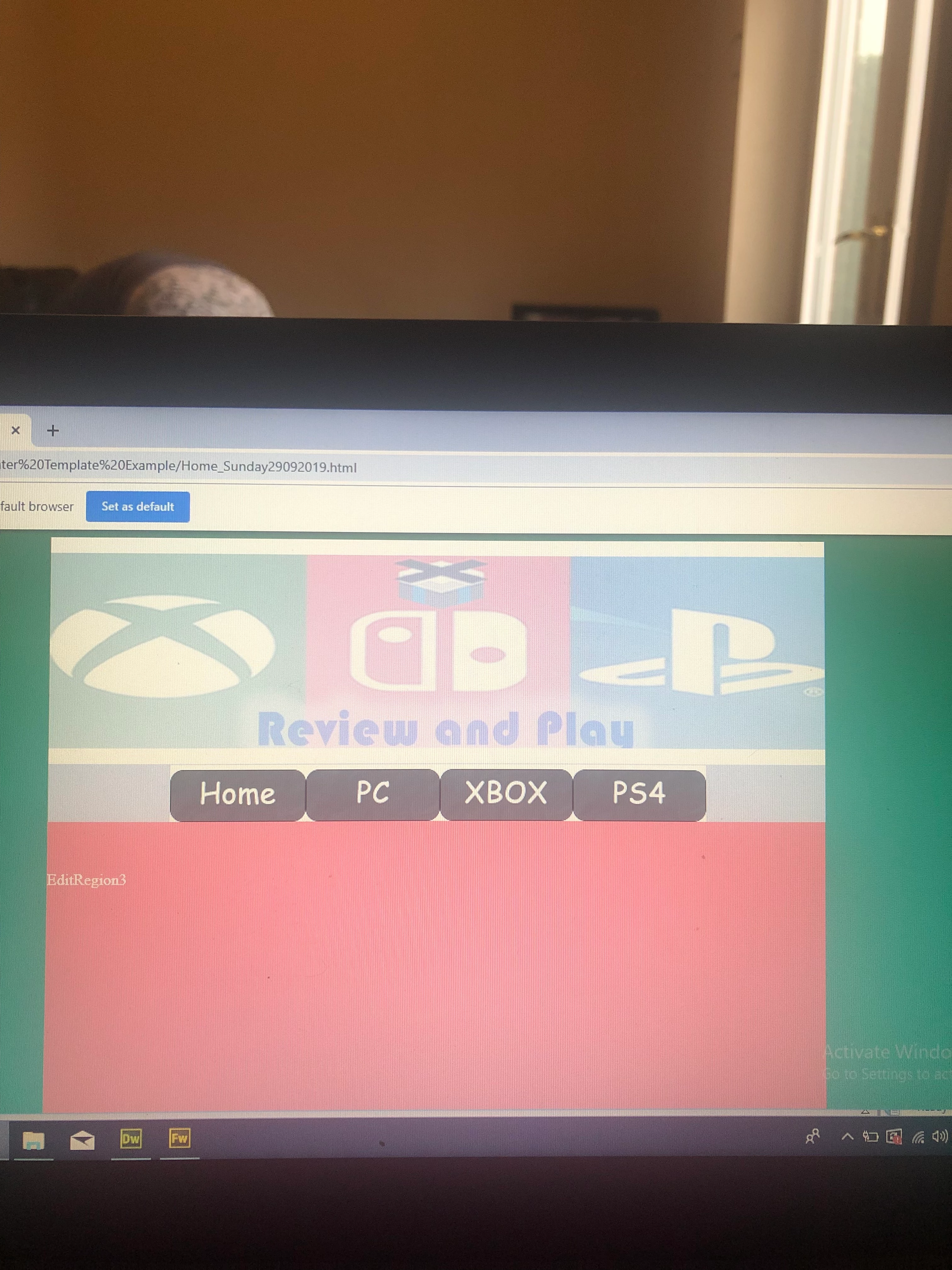

Gaps between cells when previewing in browser
 In dreamweaver
Preview in browser
Hi all,
I am just messing about with dreamweaver (hence excuse the design) and I am not sure why this is happening, but on dreamweaver I have created a table (800w) with 3 rows. On the top row I have a banner, in the next a nav bar and the 3rd row is an editable region. But as you can see in dreamweaver there are no white gaps at the top of the banner or in between the banner and nav bar. However when previewing it on the browser there is a white gap at the top of the banner and nav bar. Not sure how to fix this, please help!
Thanks in advance.

    Sep 29, 2019 5:52 PM UTC
    #1 Tables for layouts went out of favor in the late 1990's when CSS was introduced.  Nowadays, we use CSS Flexbox or css Grdis to align HTML elements.
    #2 Browsers add their own default margins and padding to all HTML elements.   One way web designers guard against browser variation is to use what's called a CSS Reset - a minified set of CSS rules that resets all styles to a consistent baseline.   See link for details.  https://cssreset.com/what-is-a-css-reset/
    A quick & dirty way to remove margins and padding from every HTML element at once is with the wildcard selector or asterisk in your CSS code like this.
    * {margin:0; padding:0}

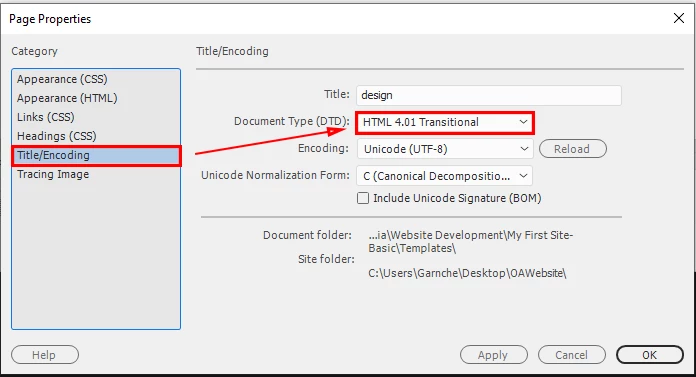

    Oct 16, 2019 6:13 PM UTC
    Go to "File"
    Select "Page Properites"
    Select "Title/Encoding"
    Change "Document Type (DTD): to "HTML 4.01 Transitional"
    Select "Apply" at the bottom of the page
    Select "OK"
    That's what I did and it fixed all our problems.
    Sep 29, 2019 9:54 PM UTC
    In addition to what Nancy has posted. You may also have to add some css to 'tighten' the images up within their container:
    img {
    display: block;
    or
    img {
    display: inline-block;
    It's better if you just target the container in which the images are inserted:
    .yourContainerName img {
    display: block;
    By targeting content in a specific container you then won't run the risk of the properties being attached to other content outside of the container, which might cause undesired results.
    BUT seriously you should NOT be using tables for your layout these days.
