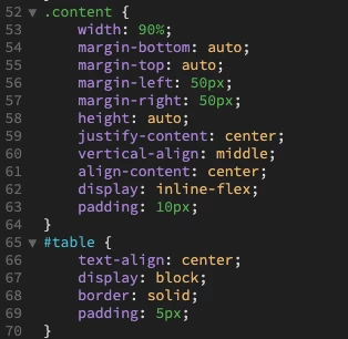

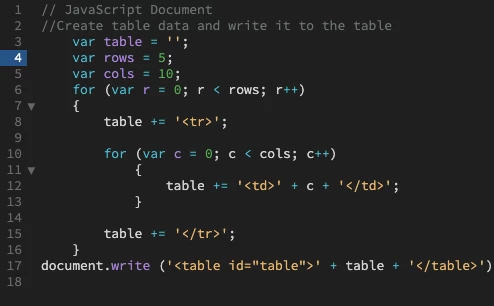

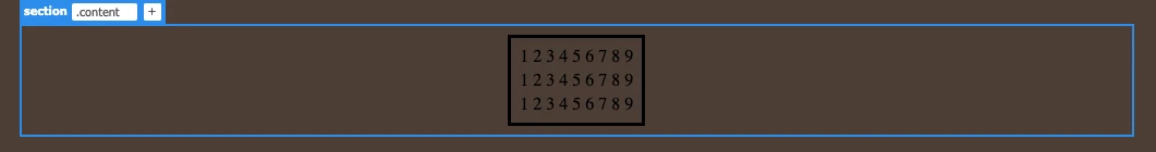

Now that's been said, and sorry if I hurt any feelings, I have included a couple of snippets of code that I managed to dig up that allows me to dynamically create a table in JavaScript and format it with CSS and HTML code. The problem that I have now is first separating the numbers into different cells, which is possibly unneccesary, and replacing the numbers with images that I believe that I may be able to achieve by placing them inside div elements generated in the same fashion as the table with the exception that if the JavaScript were able to look for a file extension inside the folders and create a div element for each one it finds in that location and then populate it on the page, I may be able to use the CSS to format those as well and the only thing that matter inside the folders is making sure all of the photos have the right file extension.
I did come across a snippet of code for Node.js on the web but unfortunately it didn't want to work with the JavaScript I'm using so I don't really want to try and learn Node.js right now just for that, maybe at a later date. So now that I feel bad for asking for help again after slapping a few wrists in the first paragraph, I'll get it over with and ask anyone who wants to answer constructively which JavaScript method/s would you reccommend that I look into to attempt this? Thanks again.
