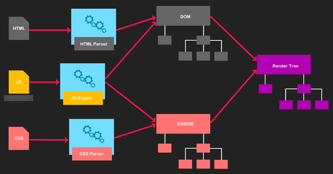

    Feb 1, 2022 10:53 PM UTC
    Adding to @Jon Fritz 's reply, if the same function can be created using CSS, then this should take preference over using JS. The reason for this is the way that these languages are processed by browser. In the following diagram you can see
    • CSS > CSS Parser > CSS Object Model > Render Tree
    • JS > JS Enginge (V8) > split and redirected to the relevant Object Model > Render Tree
    JavaScript takes much longer to process than HTML and CSS.
